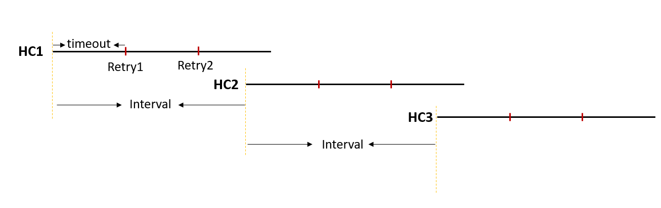

Key considerations when setting Timeout, Retry Times, and Interval
The diagram illustrates how FortiWeb’s health check mechanism uses Timeout, Retry Times, and Interval. In this example:
  • Each health check (HC) begins and, if no response is received, performs up to two retries (retry times = 2), with each retry waiting up to the configured Timeout duration.
  • Health checks can run concurrently—starting a new health check does not cancel or override an existing one that is still active. As shown in the diagram, HC2 begins while the second retry of HC1 is still in progress.
We recommend setting the interval so that the next health check begins when the last retry of the current health check is underway, as shown in the diagram above.
Example
If:
  • Timeout = 3 seconds
  • Retry Times = 2
  • Then, the recommended Interval is between 6 and 9 seconds.
This ensures:
  • Minimal overlap between health check cycles.
  • Efficient use of CPU and memory by reducing unnecessary concurrency.
  • Faster failover or recovery detection without redundant checks.

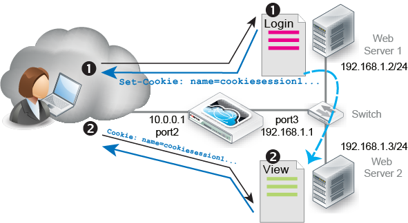

After FortiWeb has forwarded the first packet from a client to a pool member, some protocols require that subsequent packets also be forwarded to the same back-end server until a period of time passes or the client indicates that it has finished transmission.
A session persistence configuration specifies a persistence method and timeout. You apply the configuration to Server Balance server pools to apply the persistence setting to all members of the pool.

    • Insert CookieFortiWeb adds a cookie with the name specified by Cookie Name to the initial request and forwards all subsequent requests with this cookie to the same pool member. FortiWeb uses this cookie for persistence only and does not forward it to the pool member. Also configure Cookie Path and Cookie Domain.
    • Rewrite Cookie—If the HTTP response has a Set-Cookie: value that matches the value specified by Cookie Name, FortiWeb replaces the value specified by the keyword with a randomly generated cookie value. FortiWeb forwards all subsequent requests with this generated cookie value to the same pool member.
    • Persistent Cookie—If an initial request contains a cookie with a name that matches the Cookie Name value, FortiWeb forwards subsequent requests that contain the same cookie value to the same pool member as the initial request.
    • Embedded Cookie—If the HTTP response contains a cookie with a name that matches the Cookie Name value, FortiWeb preserves the original cookie value and adds a randomly generated cookie value and a ~ (tilde) as a prefix. FortiWeb forwards all subsequent requests with this cookie and prefix to the same pool member.

  • If client connections require persistent sessions, create a persistence configuration. For details, see Configuring session persistence.

    Persistence
    Select a configuration that specifies a session persistence method and timeout to apply to the pool members.
    Available only when Type is Reverse Proxy and Single Server/Server Balance is Server Balance.

    Configuring server up/down checks
    Tests for server availability (called “server health checks” in the web UI) poll web servers that are members of a server pool to determine their responsiveness before forwarding traffic. FortiWeb can check server health using the following methods:
    • TCP
    • ICMP ECHO_REQUEST (ping)
    • TCP Half Open
    • TCP SSL
    • HTTP/2
    • HTTPS
    • HTTP
    FortiWeb polls the server at the frequency set in the Timeout option. If the appliance does not receive a reply within the timeout period, and you have configured the health check to retry, it attempts a health check again; otherwise, the server is deemed unresponsive. The FortiWeb appliance reacts to unresponsive servers by disabling traffic to that server until it becomes responsive.
    If all members of the pool are unresponsive and you have configured one or more members to be backup servers, FortiWeb sends traffic to a backup server.
    If a web server will be unavailable for a long period, such as when a server is undergoing hardware repair, it is experiencing extended down time, or when you have removed a server from the server pool, you may improve the performance of your FortiWeb appliance by disabling connectivity to the web server, rather than allowing the server health check to continue to check for responsiveness. For details, see Enabling or disabling traffic forwarding to your servers.
    Example
    If:
    • Retry Times = 2
    This ensures:
    To create a persistence configuration
    1. Go to Server Objects > Server > Persistence and click Create New.
    2. Configure these settings:
    3. Name Type a unique name that can be referenced in other parts of the configuration. The maximum length is 63 characters.
      Type
      Specifies how FortiWeb determines the pool member to forward subsequent requests from a client to after its initial request. For the initial request, FortiWeb selects a pool member using the load balancing method specified in the server pool configuration.
      • Source IP—Forwards subsequent requests with the same client IP address and subnet as the initial request to the same pool member. To define how FortiWeb derives the appropriate subnet from the IP address, configure IPv4 Netmask and IPv6 Mask Length.
      • HTTP Header—Forwards subsequent requests with the same value for an HTTP header as the initial request to the same pool member. Also configure Header Name.
      • URL parameter—Forwards subsequent requests with the same value for a URL parameter as the initial request to the same pool member. Also configure Parameter Name.
      • ASP Session ID—If a cookie in the initial request contains an ASP .NET session ID value, FortiWeb forwards subsequent requests with the same session ID value to the same pool member as the initial request. FortiWeb preserves the original cookie name.
      • PHP Session ID—If a cookie in the initial request contains a PHP session ID value, FortiWeb forwards subsequent requests with the same session ID value to the same pool member as the initial request. FortiWeb preserves the original cookie name.
      • JSP Session IDFortiWeb forwards subsequent requests with the same JSP session ID as the initial request to the same pool member. FortiWeb preserves the original cookie name.
      • SSL Session ID—If a cookie in the initial request contains an SSL session ID value, FortiWeb forwards subsequent requests with the same session ID value to the same pool member as the initial request. FortiWeb preserves the original cookie name.
      IPv4 Netmask Specifies the IPv4 subnet used for session persistence.
