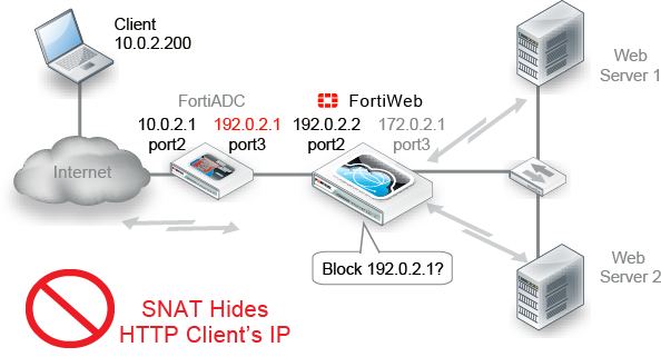

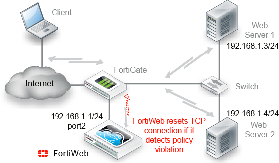

This is an example of an incorrect configuration in which a load balancer is in front of a FortiWeb and there are no X-headers:

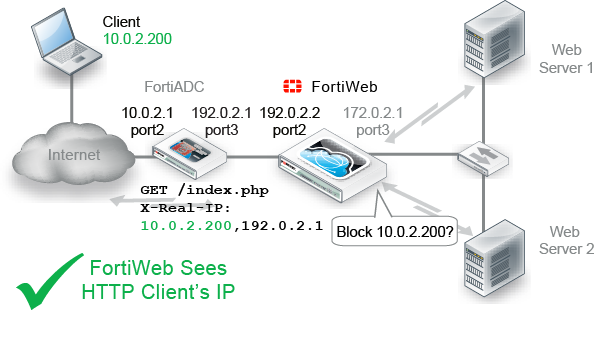

To prevent such an incorrect configuration, you must configure your devices to compensate if FortiWeb is behind your load balancer. Configure your load balancer so that it does not multiplex HTTP requests from different clients into each TCP connection with FortiWeb.
FortiWeb often applies blocking at the TCP/IP connection level, which could result in blocking innocent HTTP requests if the load balancer is transmitting them within the same TCP connection as an attack. It could therefore appear to cause intermittent failed requests. To account for this, configure your load balancer to insert or append an X-Forwarded-For:, X-Real-IP:, or other HTTP X-header. Also configure FortiWeb to find the original attacker’s or client’s IP address in that HTTP header, not in the IP session. For details, see Defining your proxies, clients, & X-headers.
Some features do not support using client IPs found in the X-header. For details, see Defining your proxies, clients, & X-headers. |

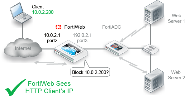

This is an example of a correct configuration in which a load balancer is in front of a FortiWeb and there are X-headers:
Do not set any Action to Period Block if the load balancer, or any other device in front of FortiWeb, applies SNAT unless you have configured blocking based upon HTTP X-headers. Period blocking based upon the source IP address at the IP layer will cause innocent requests forwarded by the SNAT device after an attack to be blocked until the blocking period expires. It could therefore appear to cause intermittent service outages. For details, see Blocking known attacks .

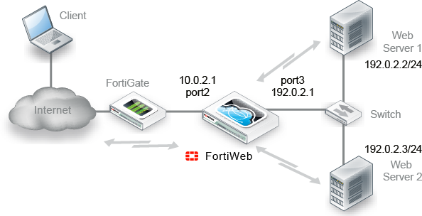

Topology for Reverse Proxy mode
This is the default operation mode, and the most common. Most features are supported. For details, see Supported features in each operation mode.
Requests are destined for a virtual server’s network interface and IP address on FortiWeb, not a web server directly. FortiWeb usually applies full NAT. FortiWeb applies the first applicable policy, then forwards permitted traffic to a web server. FortiWeb logs, blocks, or modifies violations according to the matching policy.
DNS A/AAAA record changes may be required in Reverse Proxy mode due to NAT. Also, servers will see the IP of FortiWeb, not the source IP of clients, unless you configure FortiWeb to insert/append to an HTTP X-header such as X-Forwarded-For:. Verify that the server does not apply source IP-based features such as rate limiting or geographical analysis, or, alternatively, that it can be configured to find the original client’s source IP address in an HTTP X-header.If you want to deploy without any IP and DNS changes to the existing network, consider either of the transparent modes instead. |
This is an example network topology for Reverse Proxy mode:
A client accesses two web servers over the Internet through a FortiWeb appliance. A firewall is installed between FortiWeb and the Internet to regulate non-HTTP/HTTPS traffic. Port1 is connected to the administrator’s computer. Port2 is connected to the firewall. Port3 is connected to a switch, which is connected to the web servers. The FortiWeb appliance provides load-balancing between the two web servers.

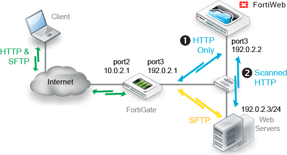

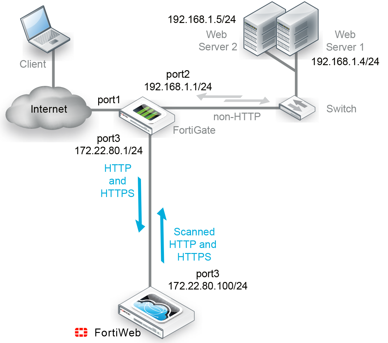

Alternatively, this is an example that shows multiple protocols originating from the client in a one-arm topology in Reverse Proxy mode:
Only HTTP/HTTPS is routed through FortiWeb for additional scanning and processing before arriving at the servers.
Virtual servers can be on the same subnet as physical servers. This is one way to create a one-arm HTTP proxy. For example, the virtual server 192.0.2.1/24 could forward to the physical server 192.0.2.2. However, this is often not recommended. Unless your network’s routing configuration prevents it, it could allow clients that are aware of the physical server’s IP address to bypass the FortiWeb appliance by accessing the physical server directly. |
By default when in Reverse Proxy mode, FortiWeb will not forward non-HTTP/HTTPS traffic from virtual servers to your protected back-end servers. By defaut, IP-based forwarding/routing of unscanned protocols is disabled.
If you must forward FTP, SSH, or other protocols to your back-end servers, we recommend that you do not deploy FortiWeb inline. Instead, use FortiGate VIP port forwarding to scan then send FTP, SSH, etc. protocols directly to the servers, bypassing FortiWeb. Deploy FortiWeb in a one-arm topology where FortiWeb receives only HTTP/HTTPS from the FortiGate VIP/port forwarding, then relays it to your web servers. Carefully test to verify that only firewalled traffic reaches your web servers.
If this is not possible, and you require FortiWeb to route non-HTTP protocols above the TCP layer, you may be able to use the config router setting command. For details, see FortiWeb CLI Reference. For security and performance reasons, this is not recommended.

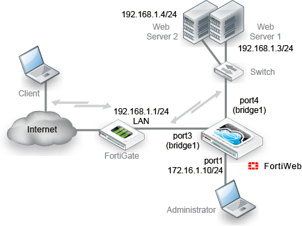

No changes to the IP address scheme of the network are required. Requests are destined for a web server, not the FortiWeb appliance. More features are supported than Offline Protection mode, but fewer than Reverse Proxy, and may vary if you use HTTPS (see also Supported features in each operation mode).
Unlike with Reverse Proxy mode, with both transparent modes, web servers will see the source IP address of clients.
You can configure VLAN subinterfaces on FortiWeb, or omit IP address configuration entirely and instead assign a network port to be a part of a Layer 2-only bridge.
In both transparent modes, the appliance will forward non-HTTP/HTTPS protocols. That is, routing /IP-based forwarding for unscanned protocols is supported. This facilitates the pass-through of other protocols such as FTP or SSH that may be necessary for a true drop-in, transparent solution. |
This is an example of a network topology for either True Transparent Proxy or Transparent Inspection mode:
A client accesses a web server over the Internet through a FortiWeb appliance. A firewall is installed between the FortiWeb appliance and the Internet to regulate non-HTTP/HTTPS traffic. Port1 is connected to the administrator’s computer. Port3 is connected to the firewall. Port4 is connected to the web servers. Port3 and port4 have no IP address of their own, and act as a V-zone (bridge). Because port3 and port4 have hardware support for fail-to-wire, this topology also gives you the option of configuring fail-open behavior in the event of FortiWeb power loss.

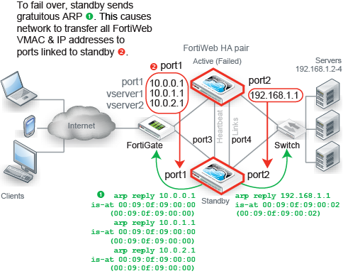

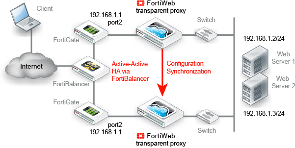

Topologies for high availability (HA) clustering
Valid HA topologies vary by whether you use either:
- FortiWeb active-passive HA

This is an example of a active-passive HA network topology in Reverse Proxy mode:
If the active appliance fails, the standby appliance assumes the IP addresses and load of the failed appliance.

Instead, most customers use an existing external load balancer/HA solution in conjunction with FortiWeb configuration synchronization to preserve an existing active-active or active-passive topology.
This is an example of a network topology in True Transparent Proxy mode with configuration synchronization and external HA via FortiADC:
Unlike with FortiWeb HA, the external HA device detects when a FortiWeb has failed and then redirects the traffic stream; FortiWeb has no way of actively notifying the external HA device. To monitor the live paths through your FortiWeb configuration, you could configure your HA device to poll either:
- A back-end web server, or
- An IP on each FortiWeb bridge (V-zone)
You can use configuration synchronization to replicate the FortiWeb configuration without HA(that is, no load balancing and no failover). Configuration synchronization has no special topology requirement, except that synchronized FortiWebs should be placed in identical topologies. For details, see Replicating the configuration without FortiWeb HA (external HA). |
