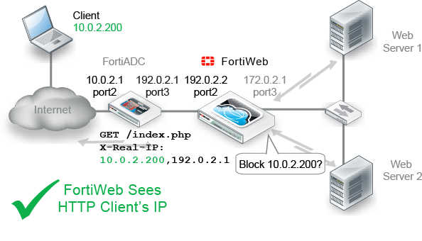

External load balancers: before or after?
Usually you should deploy FortiWeb in front of your load balancer (such as FortiBalancer, FortiADC, or any other device that applies source NAT), so that FortiWeb is between the load balancer and the clients. This has important effects:
  • Simplified configuration
  • Un-scanned traffic will not reach your load balancer, improving its performance and security
  • At the IP layer, from FortiWeb’s perspective, HTTP requests will correctly appear to originate from the real client’s IP address, not (due to SNAT) your load balancer
Otherwise, attackers’ and legitimate clients’ IP addresses may be hidden by the load balancer.
Alternatively, depending on the features that you require, you may be able to use FortiWeb’s built-in load balancing features instead. For details, see Load Balancing Algorithm.
This is an example of a network topology with a load balancer behind a FortiWeb:

To prevent such an incorrect configuration, you must configure your devices to compensate if FortiWeb is behind your load balancer. Configure your load balancer so that it does not multiplex HTTP requests from different clients into each TCP connection with FortiWeb.
FortiWeb often applies blocking at the TCP/IP connection level, which could result in blocking innocent HTTP requests if the load balancer is transmitting them within the same TCP connection as an attack. It could therefore appear to cause intermittent failed requests. To account for this, configure your load balancer to insert or append an X-Forwarded-For:, X-Real-IP:, or other HTTP X-header. Also configure FortiWeb to find the original attacker’s or client’s IP address in that HTTP header, not in the IP session. For details, see Defining your proxies, clients, & X-headers.
Some features do not support using client IPs found in the X-header. For details, see Defining your proxies, clients, & X-headers.

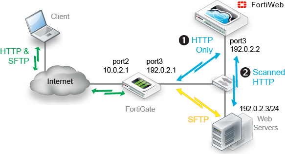

This is an example network topology for Reverse Proxy mode:
A client accesses two web servers over the Internet through a FortiWeb appliance. A firewall is installed between FortiWeb and the Internet to regulate non-HTTP/HTTPS traffic. Port1 is connected to the administrator’s computer. Port2 is connected to the firewall. Port3 is connected to a switch, which is connected to the web servers. The FortiWeb appliance provides load-balancing between the two web servers.
Alternatively, this is an example that shows multiple protocols originating from the client in a one-arm topology in Reverse Proxy mode:
Only HTTP/HTTPS is routed through FortiWeb for additional scanning and processing before arriving at the servers.
Virtual servers can be on the same subnet as physical servers. This is one way to create a one-arm HTTP proxy. For example, the virtual server 192.0.2.1/24 could forward to the physical server 192.0.2.2.
However, this is often not recommended. Unless your network’s routing configuration prevents it, it could allow clients that are aware of the physical server’s IP address to bypass the FortiWeb appliance by accessing the physical server directly.
By default when in Reverse Proxy mode, FortiWeb will not forward non-HTTP/HTTPS traffic from virtual servers to your protected back-end servers. By defaut, IP-based forwarding/routing of unscanned protocols is disabled.
If you must forward FTP, SSH, or other protocols to your back-end servers, we recommend that you do not deploy FortiWeb inline. Instead, use FortiGate VIP port forwarding to scan then send FTP, SSH, etc. protocols directly to the servers, bypassing FortiWeb. Deploy FortiWeb in a one-arm topology where FortiWeb receives only HTTP/HTTPS from the FortiGate VIP/port forwarding, then relays it to your web servers. Carefully test to verify that only firewalled traffic reaches your web servers.
If this is not possible, and you require FortiWeb to route non-HTTP protocols above the TCP layer, you may be able to use the config router setting command. For details, see FortiWeb CLI Reference. For security and performance reasons, this is not recommended.

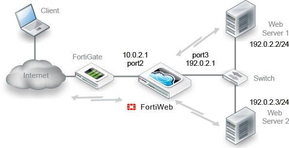

Topology for either of the transparent modes
No changes to the IP address scheme of the network are required. Requests are destined for a web server, not the FortiWeb appliance. More features are supported than Offline Protection mode, but fewer than Reverse Proxy, and may vary if you use HTTPS (see also Supported features in each operation mode).
Unlike with Reverse Proxy mode, with both transparent modes, web servers will see the source IP address of clients.
You can configure VLAN subinterfaces on FortiWeb, or omit IP address configuration entirely and instead assign a network port to be a part of a Layer 2-only bridge.
In both transparent modes, the appliance will forward non-HTTP/HTTPS protocols. That is, routing /IP-based forwarding for unscanned protocols is supported. This facilitates the pass-through of other protocols such as FTP or SSH that may be necessary for a true drop-in, transparent solution.

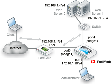

This is an example of a network topology for either True Transparent Proxy or Transparent Inspection mode:
A client accesses a web server over the Internet through a FortiWeb appliance. A firewall is installed between the FortiWeb appliance and the Internet to regulate non-HTTP/HTTPS traffic. Port1 is connected to the administrator’s computer. Port3 is connected to the firewall. Port4 is connected to the web servers. Port3 and port4 have no IP address of their own, and act as a V-zone (bridge). Because port3 and port4 have hardware support for fail-to-wire, this topology also gives you the option of configuring fail-open behavior in the event of FortiWeb power loss.
True Transparent Proxy mode and Transparent Inspection mode are the same in topology aspect, but due to differences in the mode of interception, they do have a few important behavioral differences:
  • True Transparent ProxyFortiWeb transparently proxies the traffic arriving on a network port that belongs to a Layer 2 bridge, applies the first applicable policy, and lets permitted traffic pass through. FortiWeb logs, blocks, or modifies violations according to the matching policy and its protection profile. This mode supports user authentication via HTTP but not HTTPS.
  • Transparent InspectionFortiWeb asynchronously inspects traffic arriving on a network port that belongs to a Layer 2 bridge, applies the first applicable policy, and lets permitted traffic pass through. (Because it is asynchronous, it minimizes latency.) FortiWeb logs or blocks traffic according to the matching policy and its protection profile, but does not otherwise modify it. (It cannot, for example, offload SSL, load-balance connections, or support user authentication.
Unlike in Reverse Proxy mode or True Transparent Proxy mode, actions other than Alertcannot be guaranteed to be successful in Transparent Inspection mode. The FortiWeb appliance will attempt to block traffic that violates the policy. However, due to the nature of asynchronous inspection, before FortiWeb sends the TCP Reset packet to the client or server to terminate the session, the client or server may have already received the traffic that violated the policy, or the session itself may have already ended or been deleted.

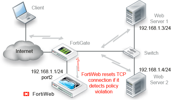

Topology for Offline Protection mode
“Out-of-band” is an appropriate descriptor for this mode. Minimal changes are required. It does not introduce any latency. However, many features are not supported. For details, see Supported features in each operation mode.
Most organizations do not permanently deploy their FortiWeb in Offline Protection mode. Instead, they will use it as a way to learn about their web servers’ vulnerabilities and to configure some of the FortiWeb during a transition period, after which they will switch to an operation mode that places the appliance inline (between clients and web servers).
Switching out of Offline Protection mode when you are done with transition can prevent bypass problems that can arise as a result of misconfigured routing. It also offers you the ability to offer protection features that cannot be supported in a SPAN port topology.
Requests are destined for a web server, not the FortiWeb appliance. Traffic is duplicated from the flow and sent on an out-of-line link to the FortiWeb through a switched port analyzer (SPAN or mirroring) port. Unless there is a policy violation, there is no reply traffic from FortiWeb. Depending on whether the upstream firewalls or routers apply source NAT (SNAT), the web servers might be able to see and use the source IP addresses of clients.
This is an example of a network topology in Offline Protection mode:
A client accesses two web servers over the Internet through a FortiWeb. A firewall is installed between the FortiWeb and the Internet to regulate non-HTTP/HTTPS traffic. Port1 is connected to the administrator’s computer. Port2 is connected to the firewall, and thereby to a switch, which is connected to the web servers. The FortiWeb provides detection, but does not load-balance, block, or otherwise modify traffic to or from the two web servers. Alternatively, you could connect a FortiWeb operating in Offline Protection mode to the SPAN port of a switch.
Unlike in Reverse Proxy mode or True Transparent Proxy mode, actions other than Alertcannot be guaranteed to be successful in Offline Protection mode. The FortiWeb appliance will attempt to block traffic that violates the policy by mimicking the client or server and requesting to reset the connection. However, the client or server may receive the reset request after it receives the other traffic due to possible differences in routing path metrics and latency.

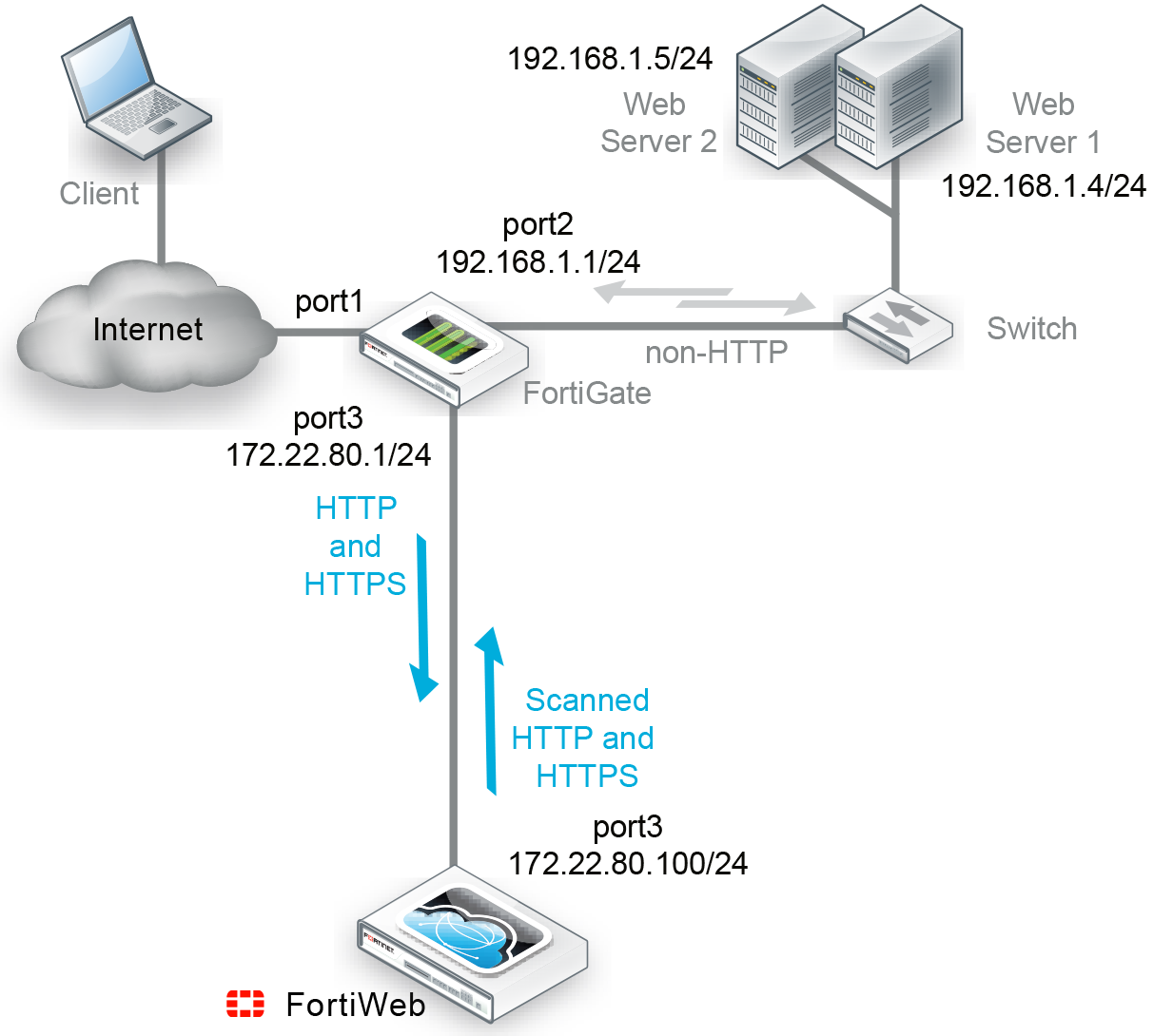

Topology for WCCP mode
WCCP mode does not require changes to the IP address scheme of the network. Requests are destined for a web server and not the FortiWeb appliance. This operation mode supports the same feature set as True Transparent Proxy mode. However, like Reverse Proxy mode, web servers see the FortiWeb network interface IP address and not the IP address of the client. For details, see Supported features in each operation mode.
This is an example of a network topology in WCCP mode:
A client accesses a web server over the Internet through a FortiWeb appliance. In this one-arm topology, a firewall is configured as a WCCP server that routes HTTP/HTTPS traffic arriving on port1 to a FortiWeb configured as a WCCP client. The firewall directs non-HTTP/HTTPS traffic to the switch directly. On the FortiWeb, Port3 is configured for the WCCP protocol and connected to the firewall.
FortiWeb applies the first applicable policy, logs, blocks, or modifies violations according to the matching policy, and then returns permitted traffic to the firewall. The firewall is configured to route HTTP/HTTPS traffic arriving on port3 to the switch.
FortiWeb monitors traffic received on the data capture port’s network interface (regardless of the IP address) and applies the first applicable policy. Because it is not inline with the destination, it does not forward permitted traffic. FortiWeb logs or blocks violations according to the matching policy and its protection profile. If FortiWeb detects a malicious request, it sends a TCP RST (reset) packet through the blocking port to the web server and client to attempt to terminate the connection. It does not otherwise modify traffic. (It cannot, for example, offload SSL, load-balance connections, or support user authentication.)
If you select Offline Protection mode, you can configure Blocking Port to select the port from which TCP RST (reset) commands are sent to block traffic that violates a policy.
