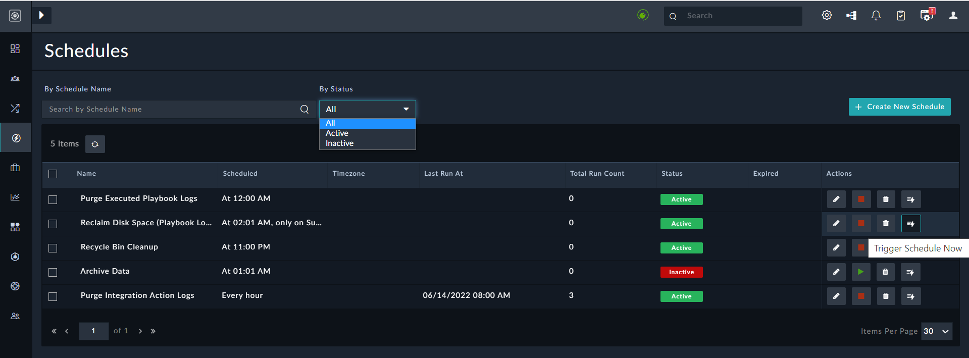

    On the Schedules page you can see the list of schedules created. You can also filter schedules by schedule name and/or By Status (Active/Inactive):
    Schedules Page

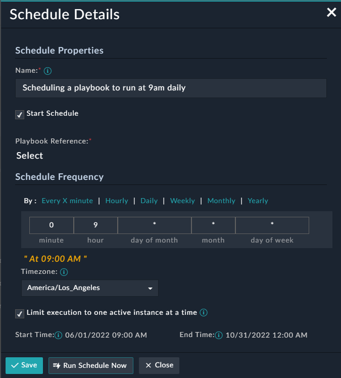

  3. In the Schedule Details dialog, enter the following details:
    1. In the Name field, add the name of the schedule.
      Note: Schedule names must be unique and comprehensive. You should be able to understand what the purpose of the schedule is by reading the name of the schedule. For example, if you want a playbook to run every day and connect to your SIEM, for example, Splunk, and gather alerts from Splunk, and then make the corresponding updates in the FortiSOAR Alerts module, you can name such a schedule as Schedule PB to run daily for Splunk Updates.
    2. If you want to start the schedule immediately after creating the schedule, click the Start Schedule checkbox.
    3. From the Playbook drop-down list, select the playbook that you want to schedule.
    4. In the Schedule Frequency field, add a valid cron expression.
      Cron expression is a string consisting of six or seven subexpressions (fields) that describe individual details of the schedule.
      In the Cron Expression section, you can click the Every X minute, Hourly, Daily, Weekly, Monthly, or Yearly links in the By row to add a schedule.
      For example, to schedule a report to run daily at 9:00 am in the morning, click the Daily link and in the Minute box type 0 and in the Hour box, type 9, as shown in the following image. A short description of the schedule also appears below the cron expression box, in our example, it appears as At 9:00 AM, which means the report will run daily at 9 am.
      Create Schedule form

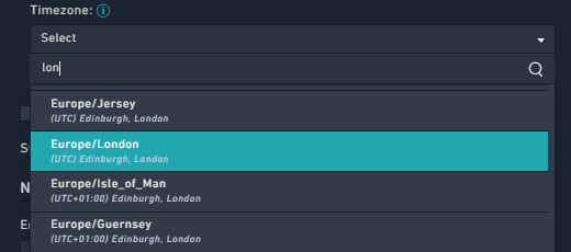

    5. From the Timezone drop-down list, search for and select the timezone in which you want to export the report associated with this schedule. By default, the timezone is set as UTC. You can search for a timezone in the Search box as shown in the following image:
      Schedule Details dialog - Search Timezone
    6. If you want to ensure that you do not rerun the workflow, if previous scheduled instance of the schedule is yet running, then click Limit execution to one active instance at a time.
    7. (Optional) In the Start Time field, you can specify the date and time from when the schedule will start running.
    8. (Optional) In the End Time field, you can specify the date and time after which the schedule will not run, i.e., the date and time to stop the schedule.
      Note: Once a schedule reaches the specified end time, then the schedule displays Yes in the Expired column on the schedules listing page. It is recommended that you should make the expired schedules "Inactive".
    9. Click Save to save the schedule.

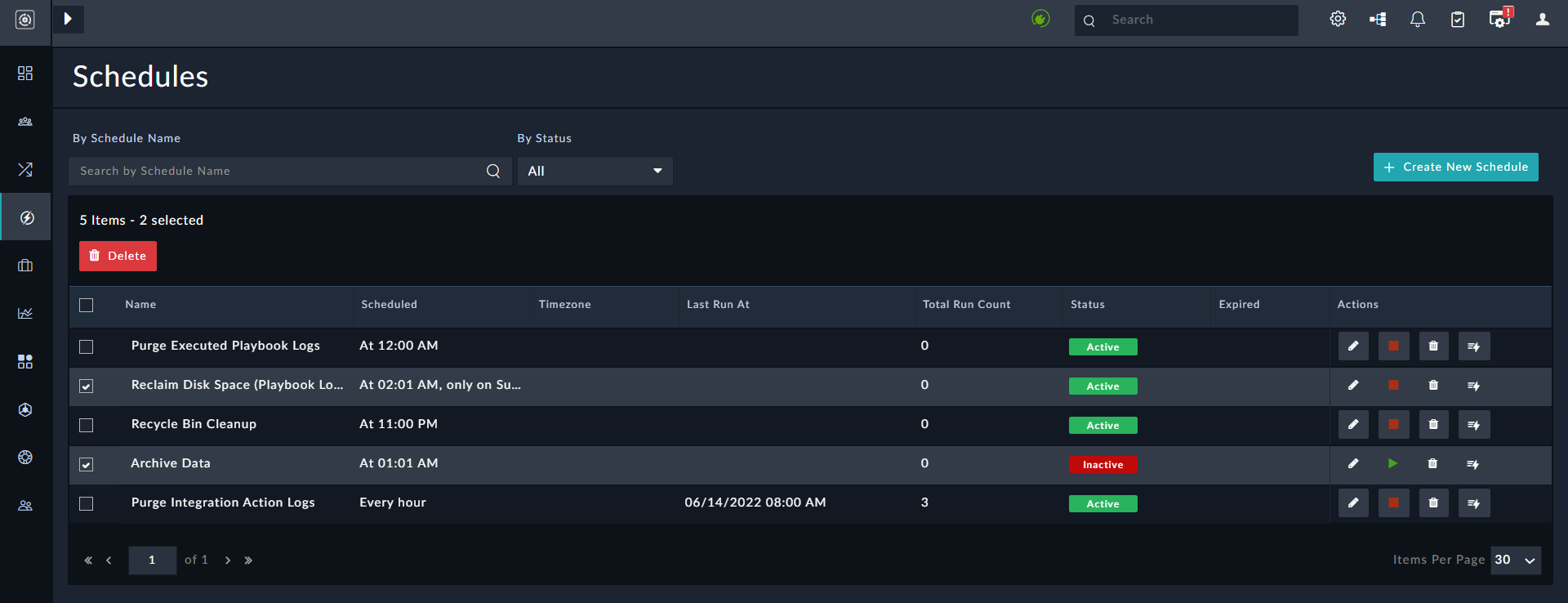

    To edit a schedule click the Edit icon in the Actions column, which will display the Schedule Details dialog in which you can edit the schedule properties.
    To delete a schedule click the Delete icon in the Actions column, which will display the Confirmation dialog and once you click OK in it the schedule gets deleted.
    If you want to delete multiple schedules, then select the schedules in the grid view and click Delete.
    Schedules Page - Deleting multiple schedules
    To run a schedule immediately (outside of its scheduled time), click the Trigger Schedule Now icon in the Actions column.
    Schedules Page
