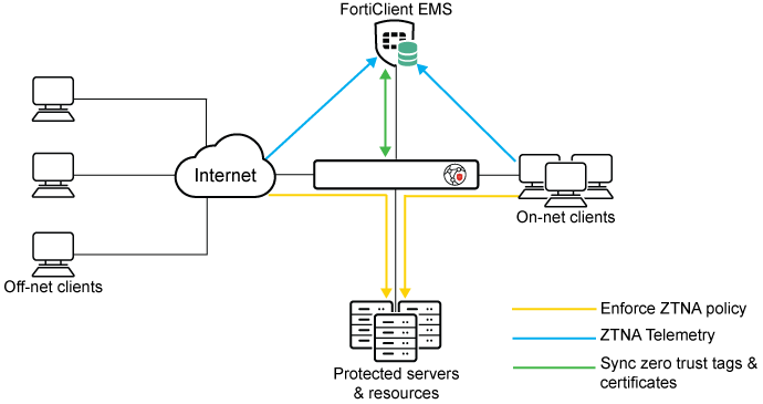

Establish device identity and trust context with FortiClient EMS
How device identity is established through client certificates, and how device trust context is established between FortiClient, FortiClient EMS, and the FortiProxy, are integral to ZTNA.
Device roles
FortiClient
FortiClient endpoints provide the following information to FortiClient EMS when they register to the EMS:
  • Device information (network details, operating system, model, and others)
  • Logged on user information
  • Security posture (On-net/Off-net, antivirus software, vulnerability status, and others)
It also requests and obtains a client device certificate from the EMS ZTNA Certificate Authority (CA) when it registers to FortiClient EMS. The client uses this certificate to identify itself to the FortiProxy.
FortiClient EMS
FortiClient EMS issues and signs the client certificate with the FortiClient UID, certificate serial number, and EMS serial number. The certificate is then synchronized to the FortiProxy. EMS also shares its EMS ZTNA CA certificate with the FortiProxy, so that the FortiProxy can use it to authenticate the clients.
FortiClient EMS uses zero trust tagging rules to tag endpoints based on the information that it has on each endpoint. The tags are also shared with the FortiProxy. See Endpoint Posture Check Reference for a list of the endpoint posture checks that EMS can perform.
Each security posture tag creates two firewall addresses in all VDOMs on a FortiProxy. One firewall address is the IP address, and the other firewall address is the MAC address. Because each FortiProxy model has a global limit and a per-VDOM limit for the maximum number of supported firewall addresses, the FortiProxy model determines the maximum number of security posture tags allowable by that unit, which is the maximum number of firewall address divided by two. For each FortiProxy model's limit, see the Maximum Values table.
FortiProxy
The FortiProxy maintains a continuous connection to the EMS server to synchronize endpoint device information, including primarily:
  • FortiClient UID
  • Client certificate SN
  • EMS SN
  • Device credentials (user/domain)
  • Network details (IP and MAC address and routing to the FortiProxy)
When a device's information changes, such as when a client moves from on-net to off-net, or their security posture changes, EMS is updated with the new device information and then updates the FortiProxy. The FortiProxy's WAD daemon can use this information when processing ZTNA traffic. If an endpoint's security posture change causes it to no longer match the ZTNA policy criteria on an existing session, then the session is terminated.

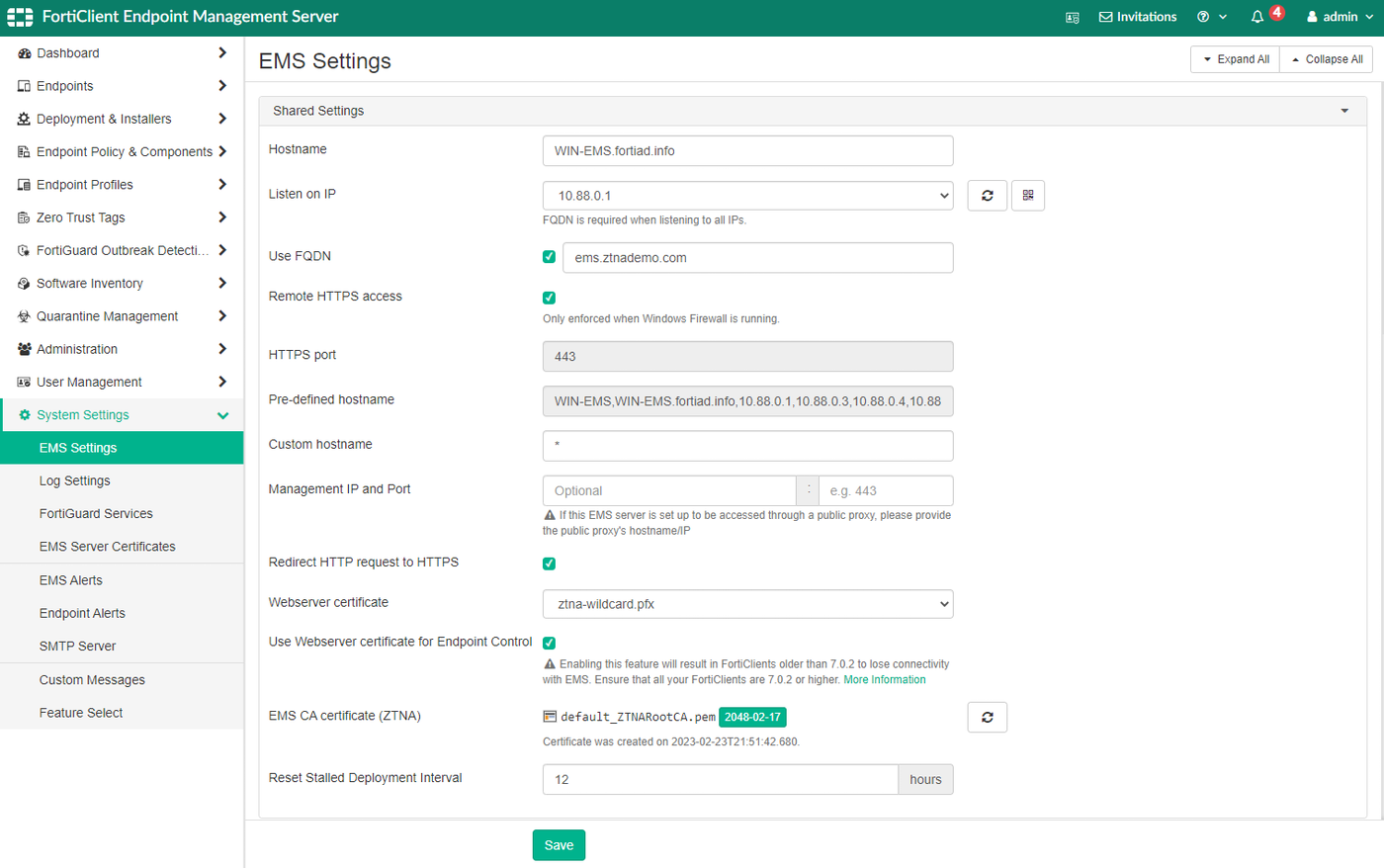

FortiClient EMS has a default_ZTNARootCA certificate generated by default that the ZTNA CA uses to sign CSRs from the FortiClient endpoints. Clicking the refresh button revokes and updates the root CA, forcing updates to the FortiProxy and FortiClient endpoints by generating new certificates for each client.
Do not confuse the EMS CA certificate (ZTNA) with the SSL certificate. The latter is the server certificate that is used by EMS for HTTPS access and fabric connectivity to the EMS server.

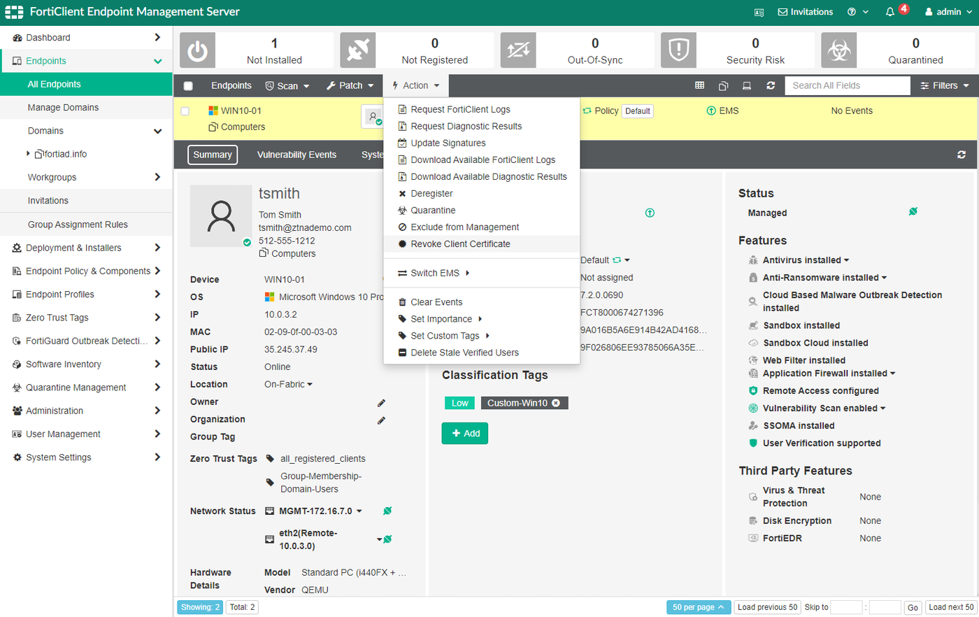

EMS can also manage individual client certificates. To revoke the current client certificate that is used by the endpoint: go to Endpoint > All Endpoints, select the client, and click Action > Revoke Client Certificate.

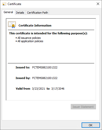

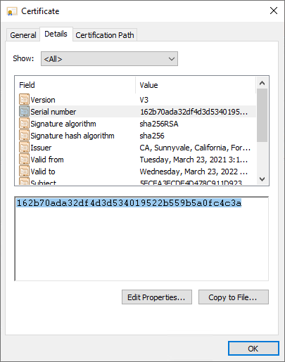

Locating and viewing the client certificate on an endpoint
In Windows, FortiClient automatically installs certificates into the certificate store. The certificate information in the store, such as certificate UID and SN, should match the information on EMS and the FortiProxy.
To locate certificates on other operating systems, consult the vendor documentation.
To locate the client certificate and EMS ZTNA CA certificate on a Windows PC:

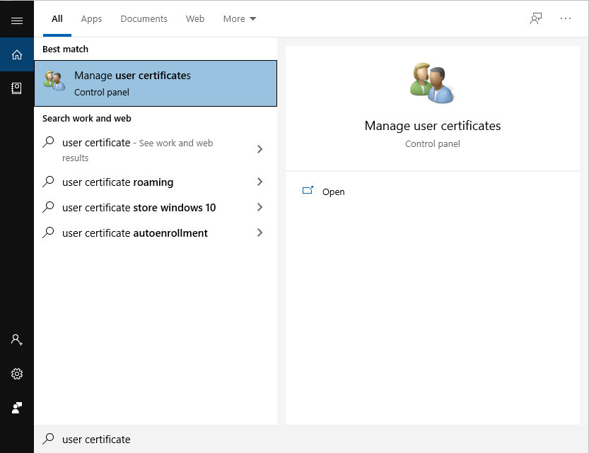

  1. In the Windows search box, enter user certificate and click Manage user certificates from the results.

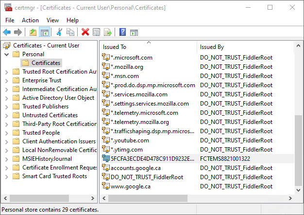

  2. In the certificate manager, go to Certificates - Current User > Personal > Certificates and find the certificate that is issued by the FortiClient EMS.

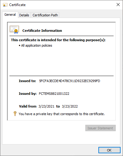

  3. Right-click on it and select Properties.
  4. The General tab shows the client certificate UID and the issue and expiry dates. The Details tab show the certificate SN.

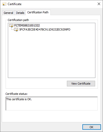

  5. Go to the Certificate Path tab to see the full certificate chain.
  6. Select the root CA and click View Certificate to view the details about the EMS ZTNA CA certificate.
Device roles
FortiClient
FortiClient EMS
FortiProxy
  • FortiClient UID
  • EMS SN
