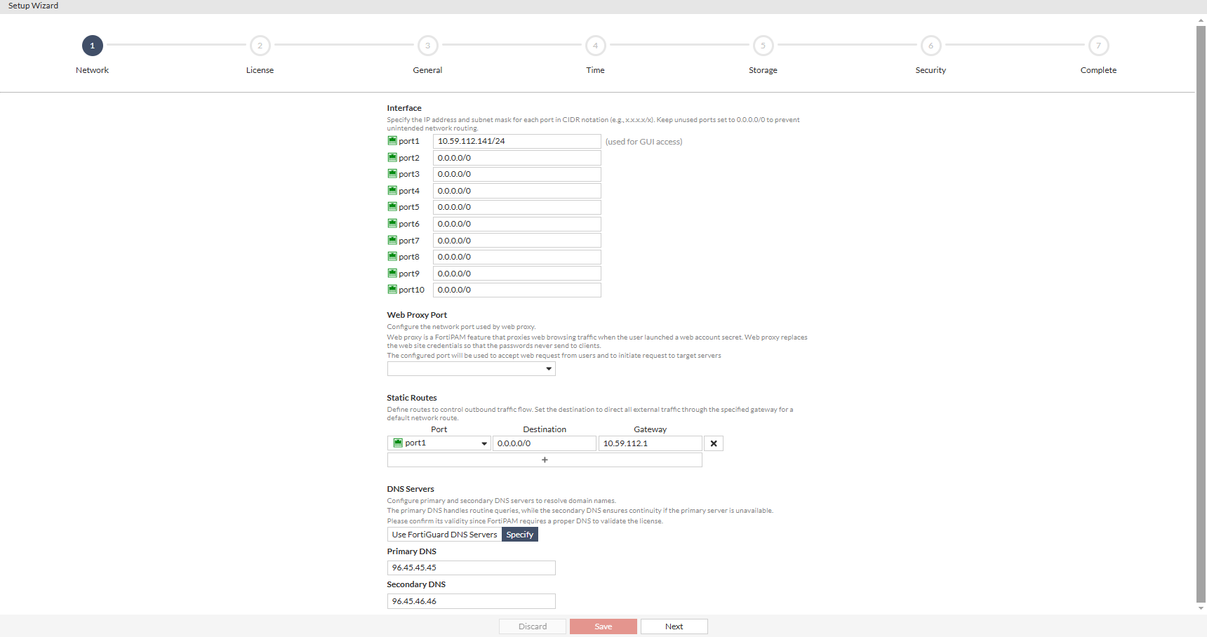

  1. Go to System > Setup Wizard.
    The Network tab opens.
    The following information is displayed:
    Interface
    Specify the IP address and the subnet mask for each port in CIDR notation, e.g., x.x.x.x/x.
    Keep the unused ports set to 0.0.0.0/0 to prevent unintended network routing.
    Web Proxy Port
    Configure the network port used by the web proxy.
    Web proxy allows FortiPAM to proxy the web browsing traffic when you launch a web account secret.
    Web proxy replaces the web credentials so that the password is never available to the client.
    The configured port is used to accept web requests to initiate request to the target server.
    Static Routes
    Define routes to control the outbound traffic.
    Set the destination to direct all the external traffic through the specified gateway for the default network route.
    DNS Servers
    Configure the primary and the secondary DNS servers to resolve the domain names.
    The primary DNS handles routine queries while the secondary DNS ensures continuity if the primary server is unavailable.
    FortiPAM requires DNS to validate the license.

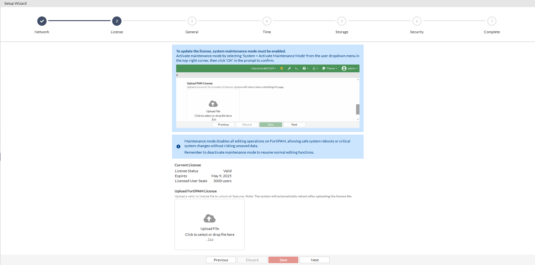

  2. Click Next.
    The License tab opens.
    The License tab displays how to update the license
    See FortiPAM license.
    To update the license, maintenance mode must be enabled. See Maintenance mode.
    The maintenance mode disables editing operations on FortiPAM to allow safe system reboots or critical system changes without risking the unsaved data.
    Note: Remember to deactivate the maintenance mode to resume normal editing functions.
    In Upload FortiPAM License, you can upload a valid .lic file.

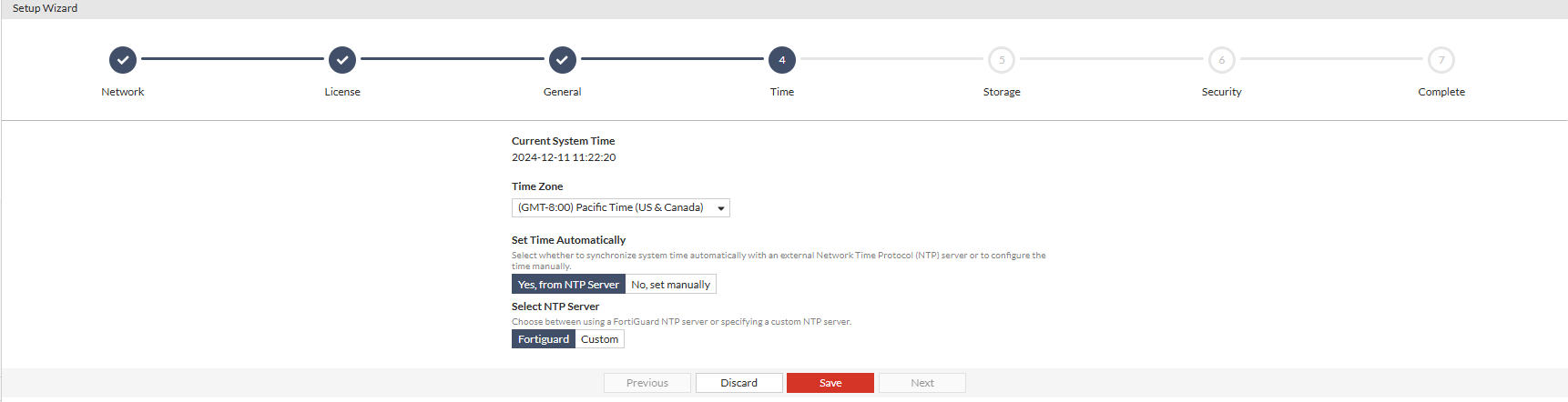

    The Time tab opens.
    The following information is displayed.
    Current System Time
    The current system time.
    Timezone
    From the dropdown, select the timezone.
    Set Time Automatically
    Select whether to synchronize the system time automatically with an external Network Time Protocol (NTP) server or to configure the time manually.
    When you select No, set manually, enter the date and time.
    Select NTP Server
    Choose between using a FortiGuard NTP server or specify a custom NTP server.
    When you select Custom, enter the NTP server IP address.
  5. Click Next.

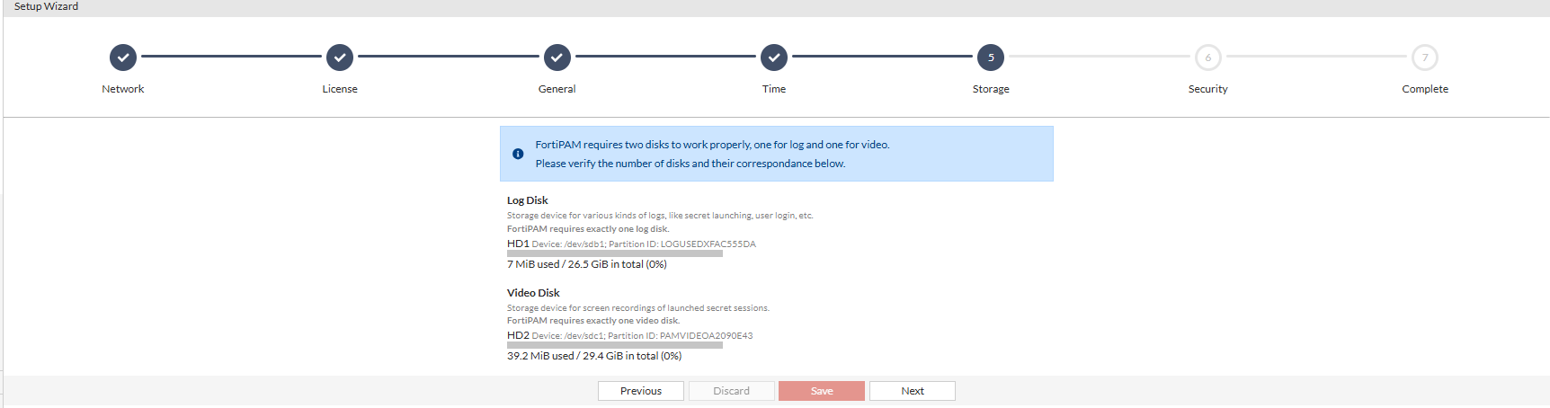

    The Storage tab opens.
    Note: FortiPAM requires two disks to work; one for log and another for video.
    Log Disk
    The storage device for various kinds of logs, e.g., secret launching, user login, etc.
    Video Disk
    The storage device for screen recording the launched secret sessions.
    Note: FortiPAM requires exactly one video disk.
  6. Click Next.

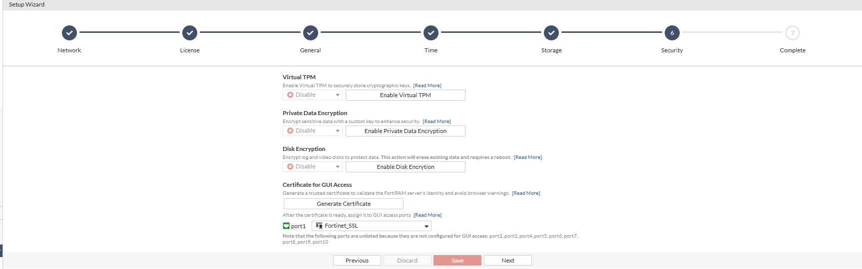

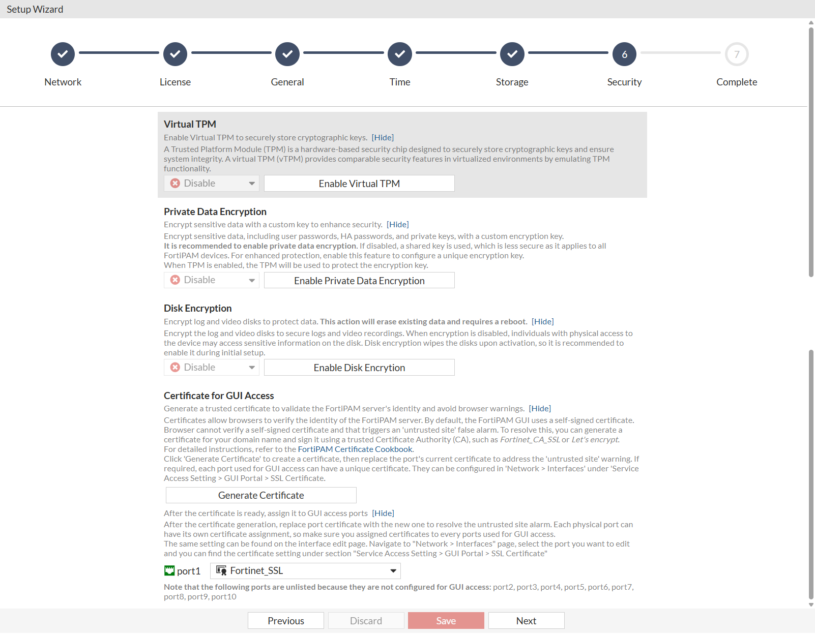

    The Security tab opens.
    Virtual TPM
    Enable vTPM to securely store cryptographic keys.
    Click Enable Virtual TPM to see the related CLI command.
      config system global
       set v-tpm enable
    You can either run the command yourself or click Run the Command in CLI. This opens a CLI console and the command runs automatically.
    Note: Maintenance mode is enabled.
    Private Data Encryption
    Encrypt sensitive date with a custom key to enhance security.
    Click Enable Private Data Encryption to see the related CLI command.
     execute disk encrption enable
    Disk Encryption
    Encrypt log and video disks to protect data.
    Note: The action erases existing data and requires a reboot.
    Click Enable Disk Encryption to see the related CLI command.
     execute disk encryption enable
    Certificate GUI Access
    Generate a trusted certificate to validate the FortiPAM server identity and avoid browser warnings.
    Select Generate Certificate.
    After the certificate is ready, assign it to the GUI access ports.
    Note: Ports not configured for GUI access are not listed.

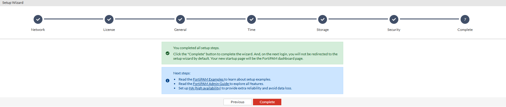

  7. Click Next.
  8. Click Complete.
Setup wizard
