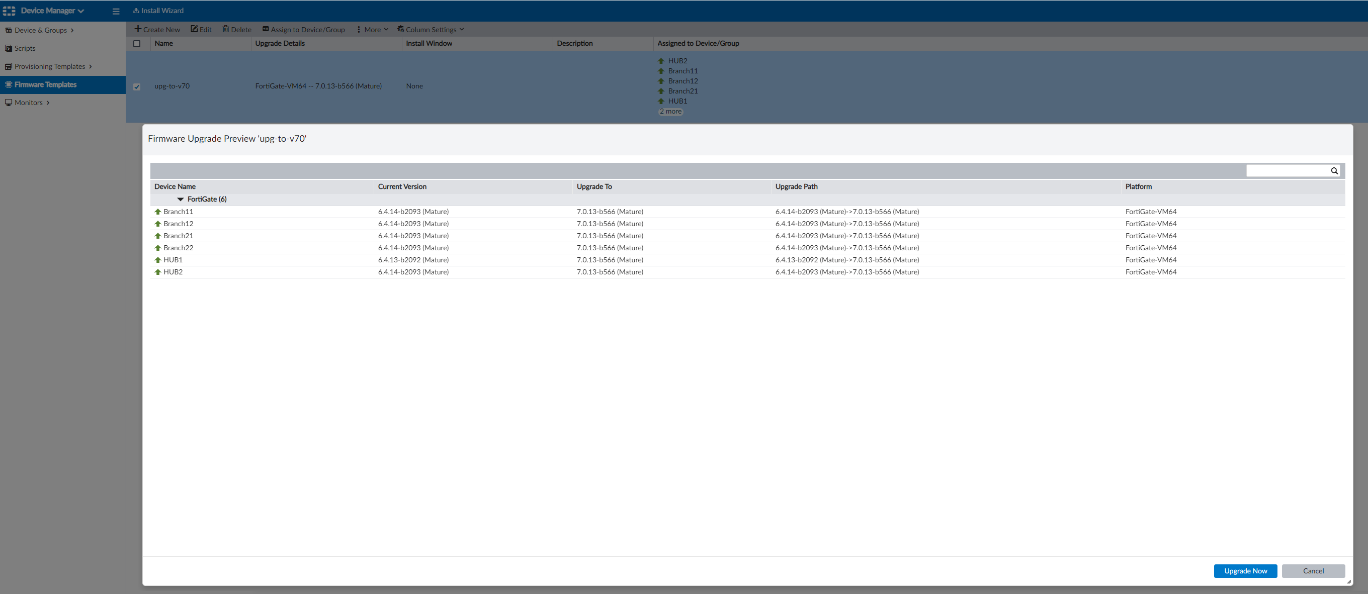

This example uses FortiManager 7.0.10. For more information, see the FortiManager 7.0.10 Upgrade Guide. - Using FortiManager Firmware Templates, upgrade FortiGate devices to the latest 7.0 version.

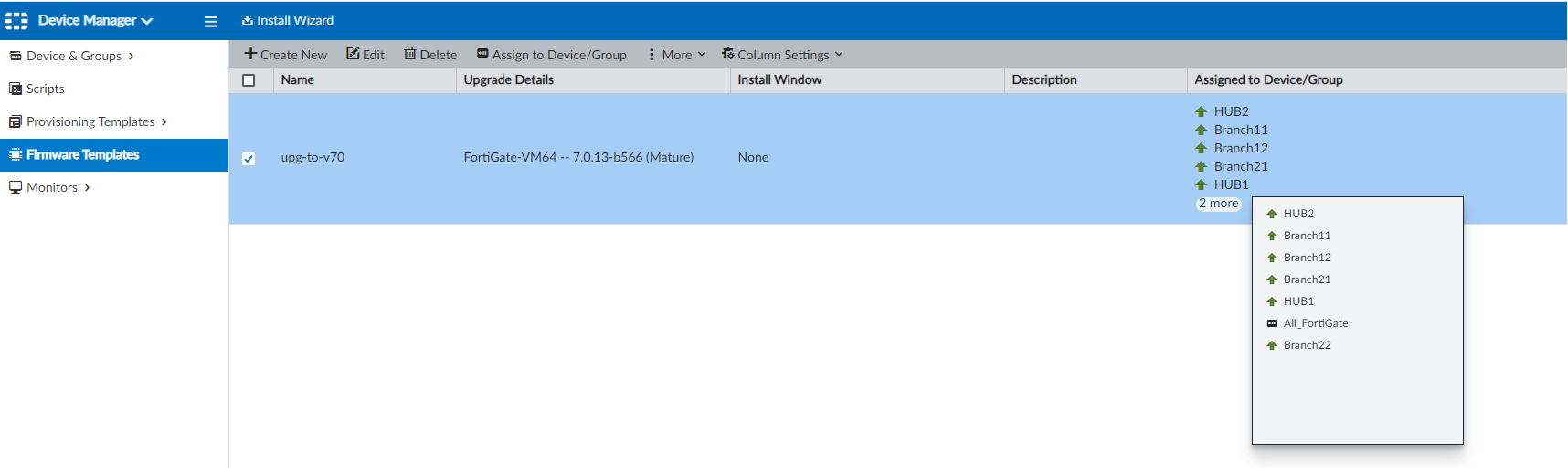

This example uses FortiOS 7.0.13. For more information, see Firmware templates.- Go to Device Manager > Firmware Templates, and click Create new.
- Assign the firmware template to the device/group that contains the FortiGate devices.
- Proceed with the upgrade.

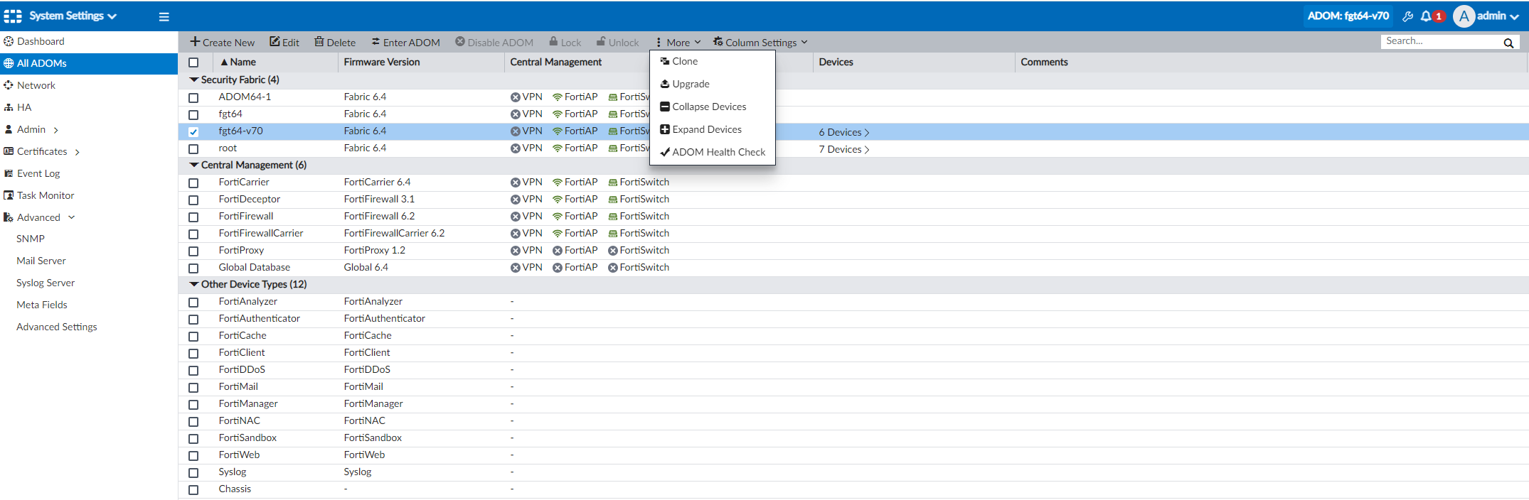

- Upgrade the ADOM to version 7.0. For more information, seeUpgrading an ADOM.
- Go to System Settings > All ADOMs.
- Select the ADOM and click More > Upgrade.
- Click OK.

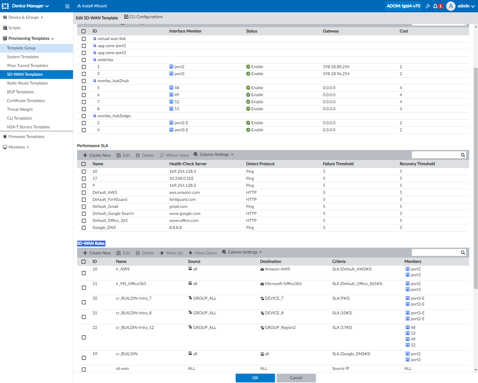

- Go to Device Manager > Provisioning Templates > SD-WAN Templates, and import the SD-WAN configuration from hub devices (e.g. hub1 and hub2).
When comparing the SD-WAN templates imported from hub1 and hub2, there are a number of differences. As a result of these differences, and the templates cannot be combined into a singular template for hubs. An example of the differences between imported templates include:- In Interface Members > Underlay, there are different gateways.
- In Performance SLA, there are different names and health-check servers.
- In SD-WAN Rules, there is a different Destination, Criteria, and Member order which is not supported by meta variables.
Example Comparison of Imported HUB templates
Example of SD-WAN template imported from hub1:
Example of SD-WAN template imported from hub2:
- Assign the imported hub1 SD-WAN template to the hub1 device, and the imported hub2 SD-WAN template to the hub 2 device.

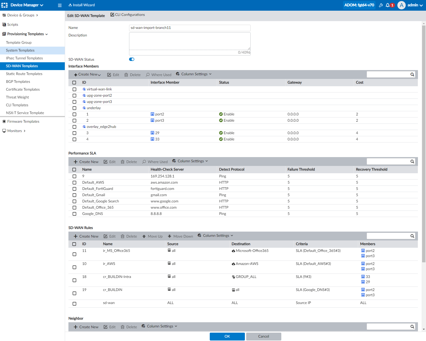

- Go to Device Manager > Provisioning Templates > SD-WAN Templates, and import the SD-WAN templates from branch devices (e.g. branch11, branch12, branch21, and branch22). When comparing the SD-WAN templates imported from branch devices, there are a number of differences. An example of the differences between imported templates include:
- In Interface Members > overlay_edge2hub, there are different interface members.
- In SD-WAN Rules, there is a different Criteria and Member order which is not supported by meta variables.
Example Comparison of Imported Branch Templates
Example of SD-WAN template imported from branch11:
Example of SD-WAN template imported from branch12:
Example of SD-WAN template imported from branch21:
Example of SD-WAN template imported from branch22:
- Assign the imported branch SD-WAN template to each branch device from which it was imported. For example:
- Assign the template imported from branch11 to the branch11 device.
- Assign the template imported from branch12 to the branch12 device.
- Assign the template imported from branch21 to the branch21 device.
- Assign the template imported from branch22 to the branch22 device.
