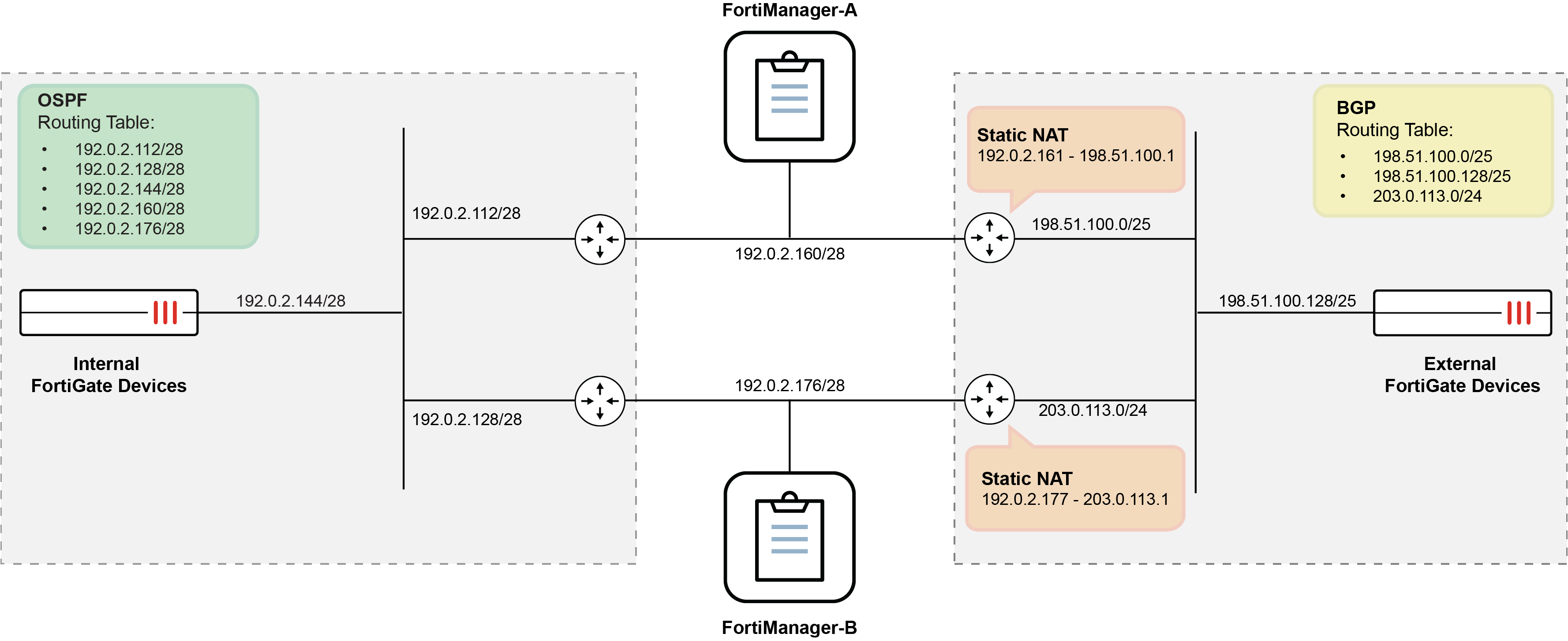

In the following scenario, HA with VRRP failover is configured for two FortiManager devices in different geographic areas for geo-redundancy using Layer 3.
In this example, FortiManager-A is on the 192.0.2.160/28 subnet and FortiManager-B is on the 192.0.2.176/28 subnet. FortiManager-A has a static NAT to public IP 198.51.100.1, and FortiManager-B has static NAT to public IP 203.0.113.1.
The internal FortiGates have internal routing to both FortiManagers using the private IPs 192.0.2.161 and 192.0.2.177 for FortiManager-A and FortiManager-B respectively. External FortiGates can reach the public IPs 198.51.100.1 and 203.0.113.1 for FortiManager-A and FortiManager-B respectively.
