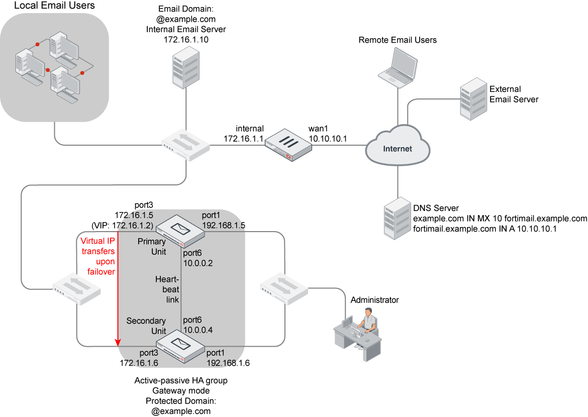

- Example: Failover scenarios
- Example: Active-passive HA group in gateway mode

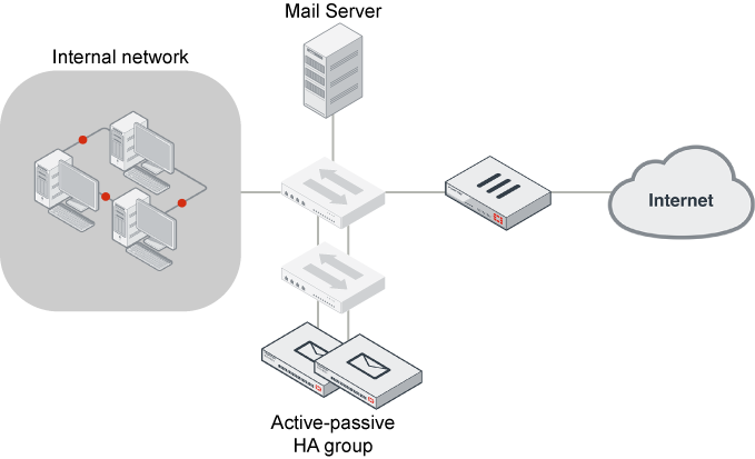

Active-passive HA group operating in gateway mode

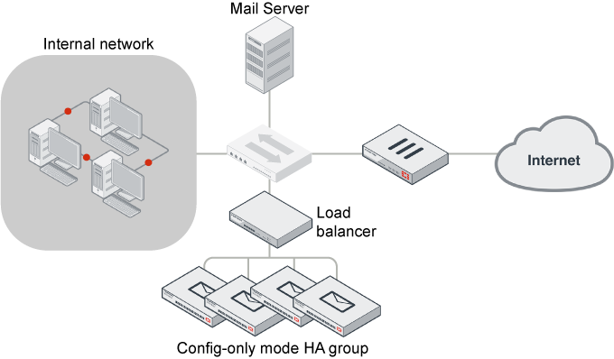

Config-only HA group operating in gateway mode
You can mix different FortiMail models in the same HA group. However, all units in the HA group must have the same firmware version.
When mixing FortiMail models, the HA group is limited by the capacity and configuration limits of the least powerful model. |

This section describes basic FortiMail active-passive HA failover scenarios. For each scenario, refer to the HA group shown in the following figure. To simplify the descriptions of these scenarios, the following abbreviations are used:
- P1 is the configured primary unit.
- S2 is the configured secondary unit.
Example active-passive HA group
This section contains the following HA failover scenarios:
This topic includes:
- Failover scenario 1: Temporary failure of the primary unit
- Failover scenario 2: System reboot or reload of the primary unit
- Failover scenario 3: System reboot or reload of the secondary unit
In this example, two FortiMail-400 units are configured to operate in gateway mode as an active-passive HA group.
The procedures in this example describe HA configuration necessary to achieve this scenario. Before beginning, verify that both of the FortiMail units are already:
- physically connected according to Virtual IP address for HA failover
- operating in gateway mode
- configured with the IP addresses for their port3 and port1 network interfaces according to Virtual IP address for HA failover, with the exception of the HA virtual IP address that will be configured in this example (for details, see Editing network interfaces)
- allowing HTTPS administrative access through their port1 network interfaces according to Virtual IP address for HA failover
The active-passive HA group is located on a private network with email users and the protected email server. All are behind a FortiGate unit which separates the private network from the Internet. The DNS server, remote email users, and external SMTP servers are located on the Internet.
For both FortiMail units:
port1 |
port3 |

The secondary unit will become the new primary unit when a failover occurs. In order for it to receive the connections formerly destined for the failed primary unit, the new primary unit must adopt the failed primary unit’s IP address. You will configure an HA virtual IP address on port3 for this purpose.
While the configured primary unit is functional, the HA virtual IP address is associated with its port3 network interface, which receives email connections. After a failover, the HA virtual IP address becomes associated with the new primary unit’s port3. As a result, after a failover, the new primary unit (originally the secondary unit) will then receive and process the email connections.

Similarly, for the HA group, DNS A records should target the IP address of the port3 interface of the primary FortiMail-400 unit. Additionally, administrators should administer each FortiMail unit in the HA group by connecting to the IP address of each FortiMail unit’s port1.
If a failover occurs, the network must be able to direct traffic to port3 of the secondary unit without reconfiguring the DNS A record target. The secondary unit must cleanly and automatically substitute for the primary unit, as if they were a single, standalone unit.
Unlike the configuration of the standalone unit, for the HA group to accomplish that substitution, all email connections must use an IP address that transfers between the primary unit and the secondary unit according to which is currently the primary unit. This transferable IP address can be accomplished by configuring the HA group to either:
- set the IP address of the current primary unit’s network interface
- add a virtual IP address to the current primary unit’s network interface
In this example, the HA group uses the method of adding a virtual IP address. Email connections will not use the actual IP address of port3. Instead, all email connections will use only the virtual IP address 172.16.1.2, which is used by port3 of whichever FortiMail unit’s effective HA operating mode is currently primary. During normal HA group operation, this IP address resides on the primary unit. Conversely, after a failover occurs, this IP address resides on the former secondary unit (now the current primary unit).
Also unlike the configuration of the standalone unit, both port5 and port6 are configured for each member of the HA group. The primary unit’s port5 is directly connected using a crossover cable to the secondary unit’s port5; the primary unit’s port6 is directly connected to the secondary unit’s port6. These links are used solely for heartbeat and synchronization traffic between members of the HA group.
For comparison with the standalone unit, examine the network configuration of the primary unit in the following table.
Example primary unit HA network interface configuration

Because the Virtual IP action settings are synchronized between the primary and secondary units, you do not need to configure them separately on the secondary unit. However, you must configure the secondary unit with other settings listed in the following table.
Example secondary unit HA network interface configuration
