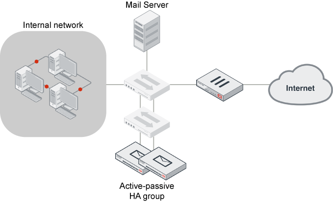

FortiMail units can operate in one of two HA modes, active-passive or config-only.
Comparison of HA modes
Active-passive HA
Config-only HA
2 FortiMail units in the HA group
2-25 FortiMail units in the HA group
Typically deployed behind a switch
Typically deployed behind a load balancer
Both configuration* and data synchronized
Only configuration* synchronized
Only primary unit processes email
All units process email
No data loss when hardware fails
Data loss when hardware fails
Failover protection, but no increased processing capacity
Increased processing capacity, but no failover protection
* For exceptions to synchronized configuration items, see Configuration settings that are not synchronized.

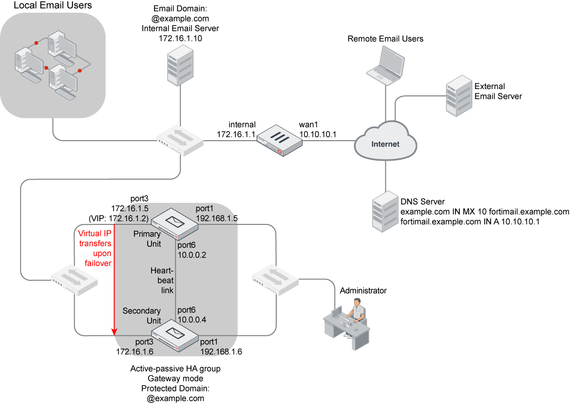

Active-passive HA group operating in gateway mode

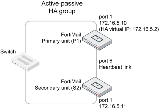

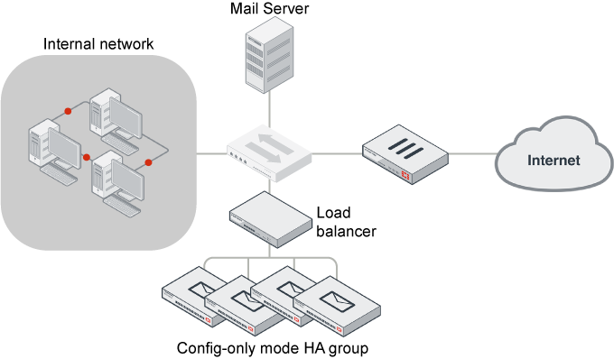

Config-only HA group operating in gateway mode
If the config-only HA group is installed behind a load balancer, the load balancer stops sending email to failed FortiMail units. All sessions being processed by the failed FortiMail unit must be restarted and will be re-directed by the load balancer to other FortiMail units in the config-only HA group.

Example: Failover scenarios
Example: Active-passive HA group in gateway mode
    In this example, two FortiMail-400 units are configured to operate in gateway mode as an active-passive HA group.
    The procedures in this example describe HA configuration necessary to achieve this scenario. Before beginning, verify that both of the FortiMail units are already:
    Virtual IP address for HA failover
    The active-passive HA group is located on a private network with email users and the protected email server. All are behind a FortiGate unit which separates the private network from the Internet. The DNS server, remote email users, and external SMTP servers are located on the Internet.
    For both FortiMail units:
    port1
    • connected to a switch which is connected only to the computer that the FortiMail administrator uses to manage the HA group
    • administrative access occurs through this port
    port3
    • connected to a switch which is connected to the private network and, indirectly, the Internet
    • email connections occur through this port
    port6
    • connected directly to each other using a crossover cable
    • heartbeat and synchronization occurs through this port
    The secondary unit will become the new primary unit when a failover occurs. In order for it to receive the connections formerly destined for the failed primary unit, the new primary unit must adopt the failed primary unit’s IP address. You will configure an HA virtual IP address on port3 for this purpose.
    While the configured primary unit is functional, the HA virtual IP address is associated with its port3 network interface, which receives email connections. After a failover, the HA virtual IP address becomes associated with the new primary unit’s port3. As a result, after a failover, the new primary unit (originally the secondary unit) will then receive and process the email connections.
    This example contains the following topics:

    Similarly, for the HA group, DNS A records should target the IP address of the port3 interface of the primary FortiMail-400 unit. Additionally, administrators should administer each FortiMail unit in the HA group by connecting to the IP address of each FortiMail unit’s port1.
    If a failover occurs, the network must be able to direct traffic to port3 of the secondary unit without reconfiguring the DNS A record target. The secondary unit must cleanly and automatically substitute for the primary unit, as if they were a single, standalone unit.
    Unlike the configuration of the standalone unit, for the HA group to accomplish that substitution, all email connections must use an IP address that transfers between the primary unit and the secondary unit according to which is currently the primary unit. This transferable IP address can be accomplished by configuring the HA group to either:
    • set the IP address of the current primary unit’s network interface
    • add a virtual IP address to the current primary unit’s network interface
    In this example, the HA group uses the method of adding a virtual IP address. Email connections will not use the actual IP address of port3. Instead, all email connections will use only the virtual IP address 172.16.1.2, which is used by port3 of whichever FortiMail unit’s effective HA operating mode is currently primary. During normal HA group operation, this IP address resides on the primary unit. Conversely, after a failover occurs, this IP address resides on the former secondary unit (now the current primary unit).
    Also unlike the configuration of the standalone unit, both port5 and port6 are configured for each member of the HA group. The primary unit’s port5 is directly connected using a crossover cable to the secondary unit’s port5; the primary unit’s port6 is directly connected to the secondary unit’s port6. These links are used solely for heartbeat and synchronization traffic between members of the HA group.
    For comparison with the standalone unit, examine the network configuration of the primary unit in the following table.
    Example primary unit HA network interface configuration
    Interface
    IP/Netmask
    Virtual IP address
    Setting
    IP address
    port1
    192.168.1.5
    Ignore
    Administrative connections to this FortiMail unit.
    Because the IP address does not follow the primary FortiMail unit, connections to this IP address are specific to this physical unit. Administrators can still connect to this FortiMail unit after failover, which may be useful for diagnostic purposes.
    port2, port4
    Default
    Ignore
    Not connected.
    port3
    172.16.1.5
    Set
    172.16.1.2
    Email connections to the FortiMail unit; the target of your email DNS MX and A records. Connections should not be destined for the actual IP address, but instead the virtual IP address (172.16.1.2) which follows the primary FortiMail unit. No administrative access.
    port5
    10.0.1.2
    Ignore
    Secondary heartbeat and synchronization interface.
    port6
    10.0.0.2
    Ignore
    Primary heartbeat and synchronization interface.
    Because the Virtual IP action settings are synchronized between the primary and secondary units, you do not need to configure them separately on the secondary unit. However, you must configure the secondary unit with other settings listed in the following table.
    Example secondary unit HA network interface configuration
    Interface
    IP/Netmask
    Virtual IP Address
    Setting
    IP address
    port1
    192.168.1.6
    (synchronized from primary unit)
    Because the IP address does not follow the primary FortiMail unit, connections to this IP address are specific to this physical unit. Administrators can connect to this FortiMail unit even when it is currently the secondary unit, which may be useful for HA configuration and log viewing.
    port2, port4
    Default
    Not connected.
    port3
    172.16.1.6
    Connections should not be destined for the actual IP address, but instead the virtual IP address (172.16.1.2) which follows the primary FortiMail unit. As a result, no connections should be destined for this network interface until a failover occurs, causing the secondary unit to become the new primary unit. No administrative access.
    port5
    10.0.1.4
    port6
    10.0.0.4

    1. Connect to the web-based manager of the secondary unit at https://192.168.1.6/admin.
    2. Go to System > Network > Interface.
    3. Configure port 6 to 10.0.0.4/255.255.255.0 and port 6 to 10.0.1.4/255.255.255.0.
    4. Go to System > High Availability > Configuration.
    5. Configure the following:
    6. Main Configuration section
      See Configuring the primary HA options
      Mode of operation
      secondary
      On failure
      wait for recovery then restore secondary role
      Shared password
      change_me
      Backup options section
      Backup mail data directories
      enabled
      Backup MTA queue directories
      disabled
      Advanced options section
      See Configuring the advanced options.
      HA base port
      2000
      Heartbeat lost threshold
      15 seconds
      Remote services as heartbeat
      disabled
      Interface section
      See Configuring interface monitoring.
      Interface
      port6
      Heartbeat status
      primary
      Peer IP address
      10.0.0.2
      Interface
      port5
      Heartbeat status
      secondary
      Peer IP address
      10.0.1.2
      Virtual IP Address
      (Configuration of the ports will be synchronized with the primary unit, and are therefore not required to be configured on the secondary unit.)
      port1
      Ignore
      port2
      Ignore
      port3
      Set
      172.16.1.2/255.255.255.0
      port4
      Ignore
      port5
      Ignore
      port6
      Ignore
    7. Click Apply.
    8. The FortiMail unit switches to active-passive HA mode, and, after determining that the primary unit is available, sets its effective HA operating mode to secondary.
    9. Go to System > High Availability > Status.
    10. Select click HERE to start a configuration/data sync.
    11. The secondary unit synchronizes its configuration with the primary unit, including Virtual IP action settings that configure the HA virtual IP that the secondary unit will adopt on failover.
    12. To confirm that the FortiMail unit is acting as the secondary unit, go to System > High Availability > Status and compare the Configured Operating Mode and Effective Operating Mode. Both should be secondary.
    13. If the effective HA operating mode is not secondary, the FortiMail unit is not acting as the secondary unit. Determine the cause of the failover, then restore the effective operating mode to that matching its configured HA mode of operation.
      If the heartbeat interfaces are not connected, the secondary unit cannot connect to the primary unit, and so the secondary unit will operate as though the primary unit has failed and will switch its effective HA operating mode to primary.
      When both primary unit and the secondary unit are operating in their configured mode, configuration of the active-passive HA group is complete. For information on managing both members of the HA group, see Administering an HA group.
    Active-passive HA
    Config-only HA

    This section describes basic FortiMail active-passive HA failover scenarios. For each scenario, refer to the HA group shown in the following figure. To simplify the descriptions of these scenarios, the following abbreviations are used:
    • P1 is the configured primary unit.
    • S2 is the configured secondary unit.
    Example active-passive HA group
    port1
    port3
    port6

    Configuring the secondary unit for HA operation
    The following procedure describes how to prepare a FortiMail unit for HA operation as the secondary unit according to Virtual IP address for HA failover.
    Before beginning this procedure, verify that you have completed the required preparations described in Example: Active-passive HA group in gateway mode. Also verify that you configured the primary unit as described in Configuring the primary unit for HA operation.
    To configure the secondary unit for HA operation
      Mode of operation
      secondary
      On failure
      Shared password
      change_me
      enabled
      disabled
      HA base port
      2000
      15 seconds
      disabled
      Interface section
      Interface
      port6
      Heartbeat status
      primary
      Peer IP address
      10.0.0.2
      Interface
      port5
      Heartbeat status
      secondary
      Peer IP address
      10.0.1.2
      Virtual IP Address
      port1
      Ignore
      port2
      Ignore
      port3
      Set
      port4
      Ignore
      port5
      Ignore
      port6
      Ignore
    7. Click Apply.
