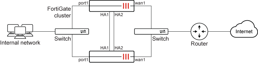

This example uses the following network topology:

  1. Make all the necessary connections as shown in the topology diagram.

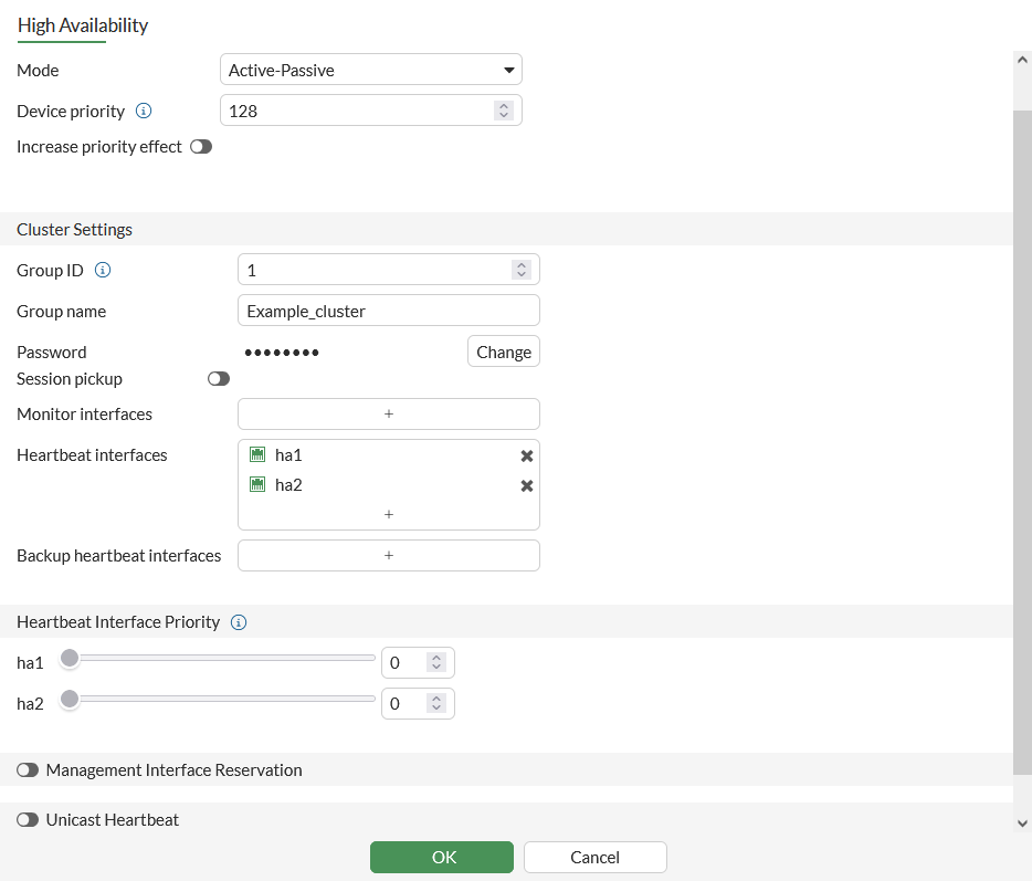

  3. Go to System > HA and set the following options:
    Option
    Value
    Mode
    Active-Passive
    Device priority
    128 or higher
    Group ID
    1
    The group ID must be the same in all HA members in order to form a cluster. The group ID can impact the definition of the virtual MAC addresses of interfaces. See Determining VMAC addresses for more details.
    Group name
    Example_cluster
    Password
    Heartbeat interfaces
    ha1 and ha2
    Except for the device priority, these settings must be the same on all FortiGates in the cluster.
  4. Leave the remaining settings as their default values. They can be changed after the cluster is in operation.
  5. Click OK.
    The FortiGate negotiates to establish an HA cluster. Connectivity with the FortiGate may be temporarily lost as the HA cluster negotiates and the FGCP changes the MAC addresses of the FortiGate's interfaces.
  6. Factory reset the other FortiGate that will be in the cluster, configure GUI access, then repeat steps 1 to 5, omitting setting the device priority, to join the cluster.
