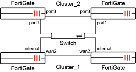

Diagnosing packet loss
A network can experience packet loss when two FortiGate HA clusters are deployed in the same broadcast domain due to MAC address conflicts. You can resolve the MAC address conflict by changing the HA group ID (or cluster ID) configuration of the two clusters.
You can diagnose packet loss by pinging from one cluster to the other, or by pinging both of the clusters from a device within the broadcast domain.
To check for a MAC address conflict in a HA cluster:
  1. On Cluster_1 and Cluster_2, check the VMAC address (Current_HWaddr) used in an interface on the primary device:
    # diagnose hardware deviceinfo nic <interface>
    If the group prefix and group hexadecimal ID are identical, there will be MAC address conflicts.
  2. Change one of the clusters to use a different group ID:
    config system ha
        set group-id <integer>
    config system ha
