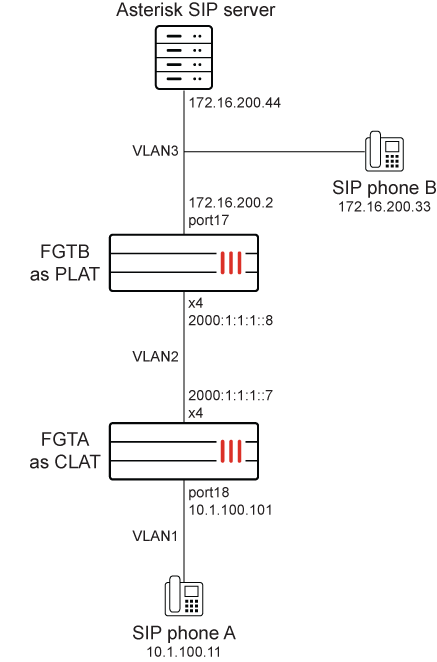

The example uses the following topology:
  1. The CLAT component run insides the user equipment (UE) and performs a one-to-one (IPv4 to IPv6) stateless translation. The CLAT component translates traffic with an IPv4 destination to IPv6. While the IPv4 address is converted to IPv6 in the IP header, the IP information within the payload, including the SIP header and body, remains unchanged (IPv4).
  2. FortiGate as PLAT performs many-to-one (IPv6 to IPv4) stateful translation to translate the IP address within the IP header from IPv6 to IPv4. Furthermore, SIP-ALG modifies the IP address within the payload in the SIP header and body by substituting the IPv4 address with a publicly NATed IP address.
  3. For traffic returning from SIP server, FortiGate stops NAT46 on the SIP payload and only translates the IPv4 addresses in the IP header into an IPv6 address. Thus, the IP address contained within the SIP header and body remains IPv4, which the user equipment can recognize, and RTP connections can be successfully established.
  4. The packet reaches UE, and the CLAT component translates the IP address of the IP header from IPv6 to IPv4. The CLAT component does not function as an ALG and does not modify the IP address within the SIP header and body.
  5. The UE receives the packet but cannot establish RTP connection with the IPv6 destination.

Example
