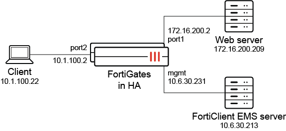

User information and TLS sessions are synchronized between HA members for ZTNA proxy sessions. When a failover occurs, the new primary unit will continue allowing sessions from the logged in users without asking for the client certificate and re-authentication again.
In this example, a FortiGate HA pair is acting as a ZTNA access proxy. Clients that are trying to access the web server on qa.test.com are proxied by the ZTNA access proxy. Remote clients must be registered to the EMS server, and pass a client certificate check and user authentication in order to connect. Upon HA member failure, a failover occurs and the new primary unit will continue to allow connections without requesting client certificate check and user authentication for existing users and devices.
This example assumes ZTNA and EMS server settings are already configured.

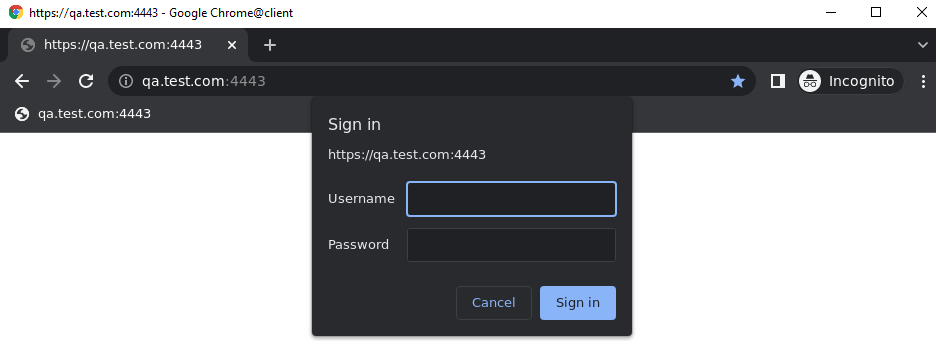

  1. On the client, access the web server. The ZTNA access proxy challenges the user for a client certificate and user authentication.

If the client tries to access the web server again after failover occurs, the client certificate check and authentication prompt does not appear. ZTNA allows the traffic to pass.
