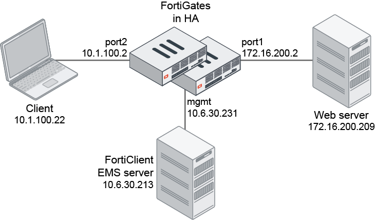

Example
In this example, a FortiGate HA pair is acting as a ZTNA access proxy. Clients that are trying to access the web server on qa.test.com are proxied by the ZTNA access proxy. Remote clients must be registered to the EMS server, and pass a client certificate check and user authentication in order to connect. Upon HA member failure, a failover occurs and the new primary unit will continue to allow connections without requesting client certificate check and user authentication for existing users and devices.
This example assumes ZTNA and EMS server settings are already configured.
