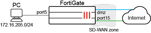

In this example, three SD-WAN rules are created:
  • Rule 1: Best quality (latency) using passive SLA for the internet services Alibaba and Amazon.
  • Rule 2: Best quality (latency) using passive SLA for the applications Netflix and YouTube.
  • Rule 3: Best quality (latency) using passive SLA for all other traffic.
After passive application measurement is enabled for rules one and two, the SLA metric of rule one is the average latency of the internet services Alibaba and Amazon, and the SLA metric of rule two is the average latency of the applications Netflix and YouTube.

  3. Verify that the SLA metrics on the members are calculated as expected:
    # diagnose sys sdwan service4
    Service(1): Address Mode(IPV4) flags=0x600 use-shortcut-sla
      Gen(1), TOS(0x0/0x0), Protocol(0: 1->65535), Mode(priority), link-cost-factor(latency), link-cost-threshold(10), health-check(Passive_HC)
      Members(2):
        1: Seq_num(2 port15), alive, latency: 15.000, selected           // Average latency of "Alibaba-Web" and "Amazon-Web" on port15:     15.000 = (0.0+30.0)/2
        2: Seq_num(1 dmz), alive, latency: 55.000, selected              // Average latency of "Alibaba-Web" and "Amazon-Web" on dmz:         55.000 = (30.0+80.0)/2
      Internet Service(2): Alibaba-Web(6881281,0,0,0) Amazon-Web(393217,0,0,0)
      Src address(1):
            172.16.205.0-172.16.205.255
    Service(2): Address Mode(IPV4) flags=0x600 use-shortcut-sla
      Gen(2), TOS(0x0/0x0), Protocol(0: 1->65535), Mode(priority), link-cost-factor(latency), link-cost-threshold(10), heatlh-check(Passive_HC)
      Members(2):
        1: Seq_num(1 dmz), alive, latency: 55.000, selected               // Average latency of "Netflix" and "YouTube" on dmz:        55.000 = (10.0+100.0)/2
        2: Seq_num(2 port15), alive, latency: 50.000, selected           // Average latency of "Netflix" and "YouTube" on port15:     50.000 = (0.0+100.0)/2
      Internet Service(2): Netflix(4294837427,0,0,0 18155) YouTube(4294838283,0,0,0 31077)
      Src address(1):
    Service(3): Address Mode(IPV4) flags=0x200 use-shortcut-sla
      Gen(9), TOS(0x0/0x0), Protocol(0: 1->65535), Mode(priority), link-cost-factor(latency), link-cost-threshold(10), health-check(Passive_HC)
      Members(2):
        1: Seq_num(2 port15), alive, latency: 46.000, selected          // Average latency of all TCP traffic on port15:       46   = (100.0+30.0+0.0+100.0+0.0)/5
        2: Seq_num(1 dmz), alive, latency: 660.000, selected           // Average latency of all TCP traffic on dmz:           660 = (3080.0+30.0+100.0+10.0+80.0)/5
      Src address(1):
      Dst address(1):
            0.0.0.0-255.255.255.255
The latency on each member interface per SD-WAN rule is the average of the latency of the application identified by respective SD-WAN rules.
The SLA metrics listed for each member interface per SD-WAN rule shown by the diagnose sys sdwan service4 and diagnose sys sdwan service6 commands are derived from the output of the SLA information for the applications shown in the output of the diagnose sys link‑monitor‑passive admin list by‑interface command.
Until the applications are identified, their SLA metrics are not used to calculate SLA metrics for each member per SD-WAN rule. Applications are identified only when there is (or was) any application traffic passing through a member interface.
