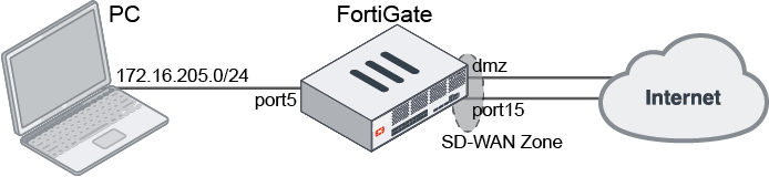

In this example, three SD-WAN rules are created:
Rule 1: Best quality (latency) using passive SLA for the internet services Alibaba and Amazon.
Rule 2: Best quality (latency) using passive SLA for the applications Netflix and YouTube.
Rule 3: Best quality (latency) using passive SLA for all other traffic.
After passive application measurement is enabled for rules one and two, the SLA metric of rule one is the average latency of the internet services Alibaba and Amazon, and the SLA metric of rule two is the average latency of the applications Netflix and YouTube.
