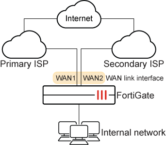

This section describes the following dual internet connection scenarios:
Scenario 1: Link redundancy and no load-sharing
Link redundancy ensures that if your Internet access is no longer available through a certain port, the FortiGate uses an alternate port to connect to the Internet.
In this scenario, two interfaces, WAN1 and WAN2, are connected to the Internet using two different ISPs. WAN1 is the primary connection. In the event of a failure of WAN1, WAN2 automatically becomes the connection to the Internet. For this configuration to function correctly, you must configure the following settings:

Scenario 3: Link redundancy and load-sharing
In this scenario, both the links are available to distribute Internet traffic with the primary WAN being preferred more. Should one of the interfaces fail, the FortiGate will continue to send traffic over the other active interface. The configuration is a combination of both the link redundancy and the load-sharing scenarios. The main difference is that the configured routes have equal distance values, with the route with a higher priority being preferred more. This ensures both routes are active in the routing table, but the route with a higher priority will be the best route.
Link health monitor
Link monitor must be configured for both the primary and the secondary WAN interfaces. This ensures that if the primary or the secondary WAN fails, the corresponding route is removed from the routing table and traffic re-routed to the other WAN interface.
For configuration details, see sample configurations in Scenario 1: Link redundancy and no load-sharing.
Routing
Both WAN interfaces must have default routes with the same distance. However, preference is given to the primary WAN by giving it a higher priority.
