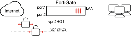

Equal cost multi-path (ECMP) is a mechanism that allows a FortiGate to load-balance routed traffic over multiple gateways. Just like routes in a routing table, ECMP is considered after policy routing, so any matching policy routes will take precedence over ECMP.
ECMP pre-requisites are as follows:
  • Routes must have the same destination and costs. In the case of static routes, costs include distance and priority
  • Routes are sourced from the same routing protocol. Supported protocols include static routing, OSPF, and BGP
