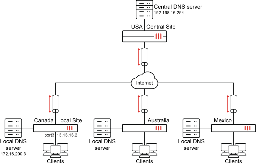

In this example, FortiGates at various locations are connected to a central site by VPN tunnels where the corporate DNS server is located. Typically, DNS queries from different sites are sent to the central DNS server and resolved to an IP local to the central site, which might cause latency and performance issues for certain destinations, such as SaaS applications.
The Local Site FortiGate is configured with the Microsoft domain and a local DNS entry. Traffic matching the Microsoft domain is either forwarded to the local DNS server or resolved by the FortiGate, which resolves it to an IP local to the Local Site, thus improving performance.
This example assumes the following have been configured:
  • A successfully operational site-to-site VPN between the Local Site and the Central Site FortiGates (see Site-to-site VPN for more information).
  • Appropriate routing and network interfaces.
  • The client PCs are configured to use the Central DNS Server.
