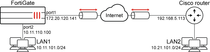

This is a sample configuration of a FortiGate VPN that is compatible with Cisco-style VPNs that use GRE in an IPsec tunnel. Cisco products with VPN support often use the GRE protocol tunnel over IPsec encryption. Cisco VPNs can use either transport mode or tunnel mode IPsec.
Topology
In this example, LAN1 users are provided with access to LAN2.
Configuring the FortiGate
There are five steps to configure GRE-over-IPsec with a FortiGate and Cisco router:
  1. Enable overlapping subnets.
  2. Configure a route-based IPsec VPN on the external interface.
  3. Configure a GRE tunnel on the virtual IPsec interface.
  4. Configure security policies.
  5. Configure the static route.
