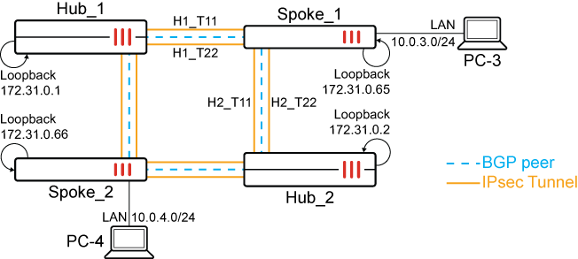

In these examples:
  • Each spoke has two IPsec tunnels to each hub, and one BGP peer on loopback interface to each hub (route-reflector).
  • The loopbacks are exchanged with IKE between the spokes and hubs. They are installed as static routes that are used to provide reachability for establishing BGP neighbors.
  • The summary BGP routes from the loopback IP address ranges that originated on the hubs are advertised to the spokes for resolving the BGP next hop s on the spokes.
  • The spokes' PC LAN subnets are reflected by the hubs.
  • Spoke_1 receives BGP routes (the LAN subnet and loopback IP summary) from Hub_1 with tag 1 and from Hub_2 with tag 2.
  • SD-WAN is enabled on Spoke_1, and all of the tunnels are SD-WAN members.

BGP next hop tag-match mode
Tag-match mode can be configured to increase flexibility when controlling how BGP routes' next hops are resolved:
config router bgp
    set tag-resolve-mode {disable | preferred | merge}
Option
Best-match (disable)
Resolve the BGP route's next hops with best-matched routes. This is the default setting.
Tag-match (preferred)
Resolve the BGP route's next hops with routes that have the same tag. If there are no results, resolve the next hops with best-matched routes.
Tag-and-best-match (merge)
Merge tag-match with best-match if they are using different routes, then let shortcuts hide their parents. The results exclude the next hops of tag-match whose interfaces have appeared in best-match.
In these examples:
Example 1: Connection between Hub and Spoke down
If the connections between Hub_1 and Spoke_2 are down, traffic from PC_3 to PC_4 can still go through Hub_1 because of the best-match resolving on Spoke_1, but packets will be dropped on Hub_1. When tag-match is enabled on Spoke_1, the spoke will resolve the PC_4 LAN route to Hub2, and traffic will be forwarded to Hub_2 and reach its destination.
To test the tag-match mode:
  1. View the key routes on Spoke_1:
    Spoke_1(root) # get router info routing-table all

    172.31.0.0/25 is the loopback IP summary originated by both Hub_1 and Hub_2. The next hop of the PC_4 LAN route is resolved to Hub_1 (H1_T11, H1_T22) and Hub_2 (H2_T11, H2_T22) based on the loopback IP summary route.
  2. When connections between Spoke_2 and Hub_1 fails due to the BGP neighbor, tunnels, or physical ports going down, the PC_4 LAN route can be still resolved to Hub_1 and Hub_2 because the loopback IP summary can still be received from both Hub_1 and Hub_2:

Example 2: SD-WAN failover when shortcut down
After the shortcut from Spoke_1 to Spoke_2 is established, Spoke_1 will only resolve the PC_4 LAN route to the shortcut, because of best-match resolving, prohibiting SD‑WAN failover. When tag-and-best-match is enabled on Spoke_1, the spoke can resolve the PC_4 LAN route to the shortcut and to other alternative tunnels, allowing SD‑WAN failover.
To test the tag-and-best-match mode:
  1. Unset tag-resolve-mode and resume the connections between Spoke_2 and Hub_1. The routing table on Spoke_1 changes to the initial state:
