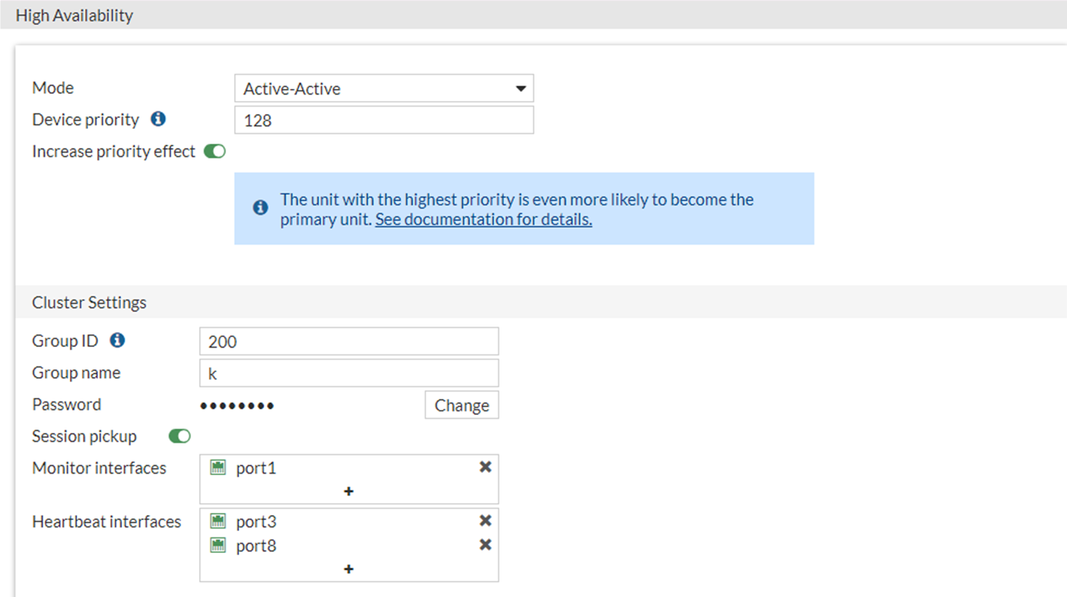

Relevant configurations
Configurations that can impact the HA primary unit section are listed below:
Priority
A value between 0-255 assigned to this unit. A higher number indicates higher priority. By default, priority is 128.
Priority value does not get synchronized to other HA members.
Monitor
Interface(s) to check for a physical link failure.
The following interface types are supported:
  • Physical interfaces
  • Aggregate interfaces
  • Redundant interfaces
Override
Enable to prioritize priority value over uptime in HA primary unit selection. Disable to prioritize uptime over priority value.
This setting is disabled by default.
To ensure optimal performance and consistent behavior in your FortiGate HA cluster, it is strongly recommended that you standardize the override configuration across all cluster members. Specifically, override should be either uniformly enabled or disabled on all cluster units. Mixed configurations can lead to conflicts and unpredictable primary unit elections, which may impact cluster stability and manageability.
From CLI:
config system ha
    set priority <integer>
    set monitor <interface list>
    set override {enable | disable}
From GUI:
On the System > HA page:

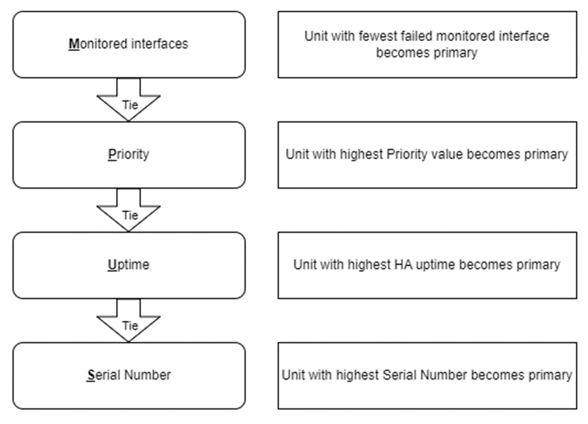

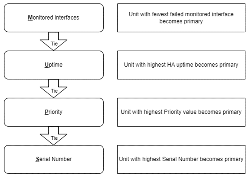

Primary unit selection criteria
If the HA override setting is disabled on all cluster members, the primary unit will be selected based on the following order:
If the HA override setting is enabled on all cluster members, the primary unit will be selected based on the following order:
For each criteria, if the value is the same, then it is considered a tie, and the next criteria is evaluated.
For the HA uptime criteria:
  • If the difference between HA uptime is more than five (5) minutes (300 seconds), the cluster unit that is operating longer becomes the primary unit.
  • If the difference between HA uptime is less than five (5) minutes (300 seconds), then the criteria is considered a tie.
  • If a monitored interface fails on a HA unit, its HA uptime is reset to zero (0).
  • If a cluster member restarts, the HA uptime is reset to zero (0).
In some documents, the terms MUPS and MPUS, which are based on the first letters of each criteria, are used to describe the order in which the criteria are considered during the HA primary unit selection process.
