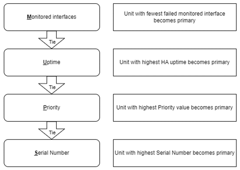

If the HA override setting is disabled on all cluster members, the primary unit will be selected based on the following order:
If the HA override setting is enabled on all cluster members, the primary unit will be selected based on the following order:
For each criteria, if the value is the same, then it is considered a tie, and the next criteria is evaluated.
For the HA uptime criteria:
If the difference between HA uptime is more than five (5) minutes (300 seconds), the cluster unit that is operating longer becomes the primary unit.
If the difference between HA uptime is less than five (5) minutes (300 seconds), then the criteria is considered a tie.
If a monitored interface fails on a HA unit, its HA uptime is reset to zero (0).
If a cluster member restarts, the HA uptime is reset to zero (0).
In some documents, the terms MUPS and MPUS, which are based on the first letters of each criteria, are used to describe the order in which the criteria are considered during the HA primary unit selection process. |
