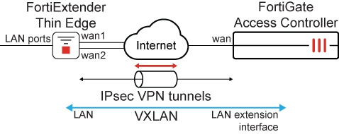

LAN extension mode
The LAN extension configuration mode allows FortiExtender to provide remote thin edge connectivity back to the FortiGate over a backhaul connection. A FortiExtender deployed at a remote location will discover the FortiGate access controller (AC) and form an IPsec tunnel (or multiple tunnels when multiple links exist on the FortiExtender) back to the FortiGate. A VXLAN is established over the IPsec tunnels to create an L2 network between the FortiGate and the network behind the remote FortiExtender.

LAN extension mode
