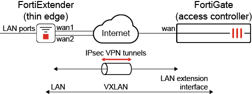

LAN extension mode
The LAN extension configuration mode allows FortiExtender to provide remote thin edge connectivity back to the FortiGate over a backhaul connection. A FortiExtender deployed at a remote location will discover the FortiGate access controller (AC) and form an IPsec tunnel (or multiple tunnels when multiple links exist on the FortiExtender) back to the FortiGate. A VXLAN is established over the IPsec tunnels to create an L2 network between the FortiGate and the network behind the remote FortiExtender.
For more information, see FortiExtender as FortiGate LAN extension in the FortiExtender (Managed) Administration Guide.
