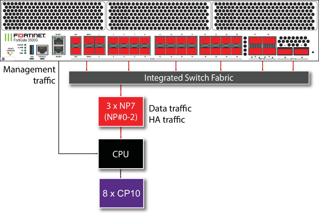

FortiGate 3500G and 3501G fast path architecture
The FortiGate 3500G and 3501G each include three NP7 processors and eight CP10 processors. All front panel data interfaces, front panel HA interfaces and the NP7 processors connect to the integrated switch fabric (ISF). All data traffic passes from the data interfaces through the ISF to the NP7 processors. Because of the ISF, all supported traffic passing between any two data interfaces can be offloaded by the NP7 processors. Data traffic processed by the CPU takes a dedicated data path through the ISF and an NP7 processor to the CPU.
The FortiGate 3500G and 3501G models feature the following front panel interfaces:
- Two 10G/5G/2.5G/1G/100M BASE-T RJ45 (MGMT1 and MGMT2, not connected to the NP7 processors).
- Thirty 25/10 GigE SFP28 (HA1, HA2, WAN1, WAN2, 1 to 26).
- Four 100/40 GigE QSFP28 (27 to 30). Each of these interfaces can be split into four 25/10/1 GigE SFP28 interfaces.
- Two 400/200/100/40 GigE QSFP-DD (31 and 32). Each of these interfaces can be split into eight 50GigE interfaces, four 100 GigE interfaces, or two 200 GigE interfaces.
The MGMT interfaces are not connected to the NP7 processors. Management traffic passes to the CPU over a dedicated management path that is separate from the data path. You can also dedicate separate CPU resources for management traffic to further isolate management processing from data processing (see Improving GUI and CLI responsiveness (dedicated management CPU)).
The HA interfaces are connected to the ISF and NP7 processors.
The separation of management traffic from data traffic keeps management traffic from affecting the stability and performance of data traffic processing.
You can use the following command to display the FortiGate 3500G and 3501G NP7 configuration. The command output shows that the NP7s are connected to the HA interfaces (HA1_np and HA2_np) and to all data interfaces.

The integrated switch fabric distributes sessions from the data interfaces to the NP7 processors. The three NP7 processors have a bandwidth capacity of 200Gigabit x 3 = 600 Gigabit. If all interfaces were operating at their maximum bandwidth, the NP7 processors would not be able to offload all the traffic. You can use NPU port mapping to control how sessions are distributed to NP7 processors.
