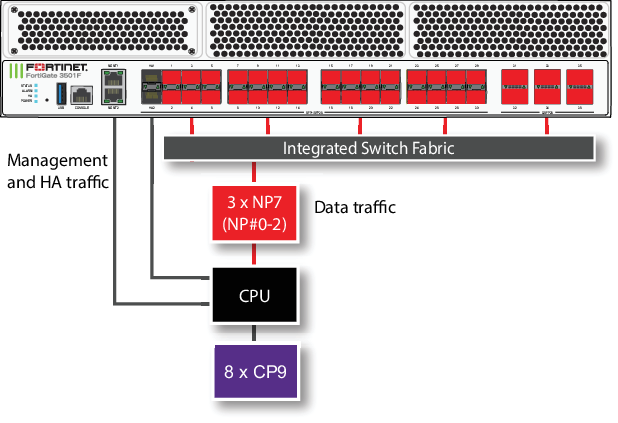

The FortiGate 3500F and 3501F each include three NP7 processors. All front panel data interfaces and the NP7 processors connect to the integrated switch fabric (ISF). All data traffic passes from the data interfaces through the ISF to the NP7 processors. Because of the ISF, all supported traffic passing between any two data interfaces can be offloaded by the NP7 processors. Data traffic processed by the CPU takes a dedicated data path through the ISF and an NP7 processor to the CPU.
The FortiGate 3500F and 3501F models feature the following front panel interfaces:
  • Two 10G/5G/2.5G/1G/100M BASE-T RJ45 (MGMT1 and MGMT2, not connected to the NP7 processors).
  • Thirty-two 25/10/1 GigE SFP28/SFP+/SFP (HA1, HA2, 1 to 30), the HA interfaces are not connected to the NP7 processors. Every time you change the speed of one of these interfaces from 25Gbps to 10Gbps or 1Gbps or from 10Gbps or 1Gbps to 25Gbps the speeds of the other interfaces in the group also change to that speed. When you enter the end command, the CLI confirms the range of interfaces affected by the change.
  • Six 100/40 GigE QSFP28 (31 to 36). Each of these interfaces can be split into four 25/10/1 GigE SFP28 interfaces.
The MGMT interfaces are not connected to the NP7 processors. Management traffic passes to the CPU over a dedicated management path that is separate from the data path. You can also dedicate separate CPU resources for management traffic to further isolate management processing from data processing (see Improving GUI and CLI responsiveness (dedicated management CPU)).
The HA interfaces are also not connected to the NP7 processors. To help provide better HA stability and resiliency, HA traffic uses a dedicated physical control path that provides HA control traffic separation from data traffic processing.
The separation of management and HA traffic from data traffic keeps management and HA traffic from affecting the stability and performance of data traffic processing.

The integrated switch fabric distributes sessions from the data interfaces to the NP7 processors. The three NP7 processors have a bandwidth capacity of 200Gigabit x 3 = 600 Gigabit. If all interfaces were operating at their maximum bandwidth, the NP7 processors would not be able to offload all the traffic. You can use NPU port mapping to control how sessions are distributed to NP7 processors.

port15   25000           10000            8               15         1               0         49         n/a
port16   25000           10000            8               16         1               0         50         n/a
port17   25000           10000            8               17         1               0         51         n/a
port18   25000           10000            8               18         1               0         52         n/a
port19   25000           10000            8               19         1               0         61         n/a
port20   25000           10000            8               20         1               0         62         n/a
port21   25000           10000            8               21         1               0         63         n/a
port22   25000           10000            8               22         1               0         64         n/a
port23   25000           10000            8               23         1               0         57         n/a
port24   25000           10000            8               24         1               0         58         n/a
port25   25000           10000            8               25         1               0         59         n/a
port26   25000           10000            8               26         1               0         60         n/a
port27   25000           10000            8               27         1               0         71         n/a
port28   25000           10000            8               28         1               0         72         n/a
port29   25000           10000            8               29         1               0         73         n/a
port30   25000           10000            8               30         1               0         74         n/a
port31   100000          100000           8               33         1               0         79         n/a
port32   100000          100000           8               34         1               0         67         n/a
port33   100000          100000           8               35         1               0         95         n/a
port34   100000          100000           8               36         1               0         87         n/a
port35   100000          100000           8               37         1               0         123        n/a
port36   100000          100000           8               38         1               0         99         n/a
Name     sw_id hash nr_link valid default sw_tid
NP Port:
Name   Switch_id SW_port_id SW_port_name
np0_0  0         5          n/a
np0_1  0         13         n/a
np1_0  0         127        n/a
np1_1  0         1          n/a
np2_0  0         107        n/a
np2_1  0         115        n/a
* Max_speed: Maximum speed, Dflt_speed: Default speed
* SW_port_id: Switch port ID, SW_port_name: Switch port name
The command output also shows the maximum and default speeds of each interface.
You can add LAGs to improve performance. For details, see Increasing NP7 offloading capacity using link aggregation groups (LAGs).
The FortiGate-3500F and 3501F can be licensed for hyperscale firewall support, see the Hyperscale Firewall Guide.
