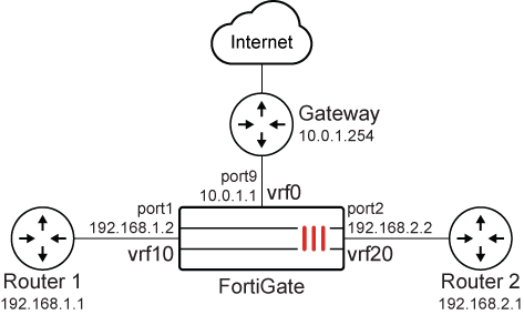

This example uses the following topology:
BGP routes learned from the Router1 neighbor are put into vrf10.
BGP routes learned from the Router2 neighbor are put into vrf20.

Results
Using the above topology:
Both Router1 and Router2 establish OSPF and BGP neighbor with the FortiGate.
Router1 advertises 10.10.1.0/24 into OSPF and 10.10.2.0/24 into BGP.
Router2 advertises 20.20.1.0/24 into OSPF and 20.20.2.0/24 into BGP.
