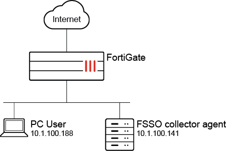

In this example, the logon timeout is set for four minutes.
To configure the FSSO logon timeout:
Set the timeout value:
config user fsso edit "ad" set server "10.1.100.141" set password ******** set logon-timeout 4 next end -
