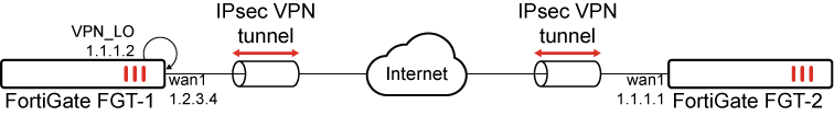

For example, consider the following topology where an IPsec tunnel is terminated on a loopback interface, VPN_LO, on the FortiGate FGT-1 and on a WAN interface on the FortiGate FGT-2.
We will focus on the configuration required for FortiGate FGT-1.
IPsec tunnel terminates on a loopback interface, VPN_LO, which has an associated IP address that the remote peer will use as its IPsec remote gateway address.
The IPsec tunnel uses wan1 as its underlay interface.
In this scenario, the administrator of the FortiGate FGT-1 device must configure a firewall policy from the wan1 interface to the VPN_LO interface that allows incoming traffic from the remote peer to reach the VPN_LO interface for proper IPsec tunnel connectivity.
