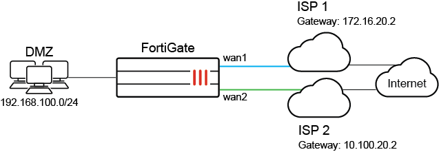

Example
In this example, SD-WAN interfaces, wan1 and wan2, are connected to two different internet service providers (ISPs), both providing access to the public internet. The preference is for Gmail services to use the link with the highest bandwidth.
