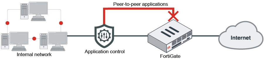

Application control
FortiGates can recognize network traffic generated by a large number of applications. Application control sensors specify what action to take with the application traffic. Application control uses IPS protocol decoders that can analyze network traffic to detect application traffic, even if the traffic uses non-standard ports or protocols. Application control supports traffic detection using the HTTP protocol (versions 1.0, 1.1, and 2.0).
FortiOS includes three preloaded application sensors:
- default (monitors all applications)
- wifi-default (default configuration for offloading WiFi traffic)
- block-high-risk
You can customize these sensors, or you can create your own to log and manage the applications on your network.
Once configured, you can add the application sensor to a firewall policy.
