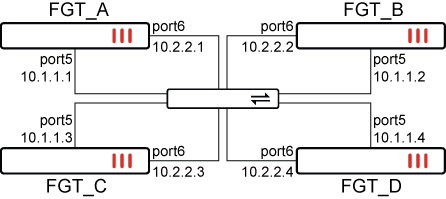

In this example where standalone FortiGates are peered in FGSP, using session-sync-dev optimizes session synchronization as it eliminates UDP encapsulation and offloads session synchronization processing to the kernel. FGSP session synchronization can be supported to handle heavy loads.
For more information about session synchronization, see Session synchronization interfaces in FGSP.
Topology
In this topology, there are three FGSP peer groups for each FortiGate. Sessions are synchronized between each FortiGate and its peer groups. Redundancy is achieved by using two dedicated session sync device links for each peer setup. There are a total of six peer IPs for each session synchronization device link in each FGSP peer. When one link is fails, session synchronization is not affected.
For optimization, sync-packet-balance is enabled to distribute synchronization packets processing to multiple CPUs. The session synchronization process is offloaded to the kernel, and sessions are synchronized over layer 2 over the connected interfaces (set session-sync-dev "port5" "port6"). Jumbo frame MTU 9216 is configured on each session synchronization device link to reduce the number of packets; however, setting MTU to 9216 is entirely optional.
Topology
