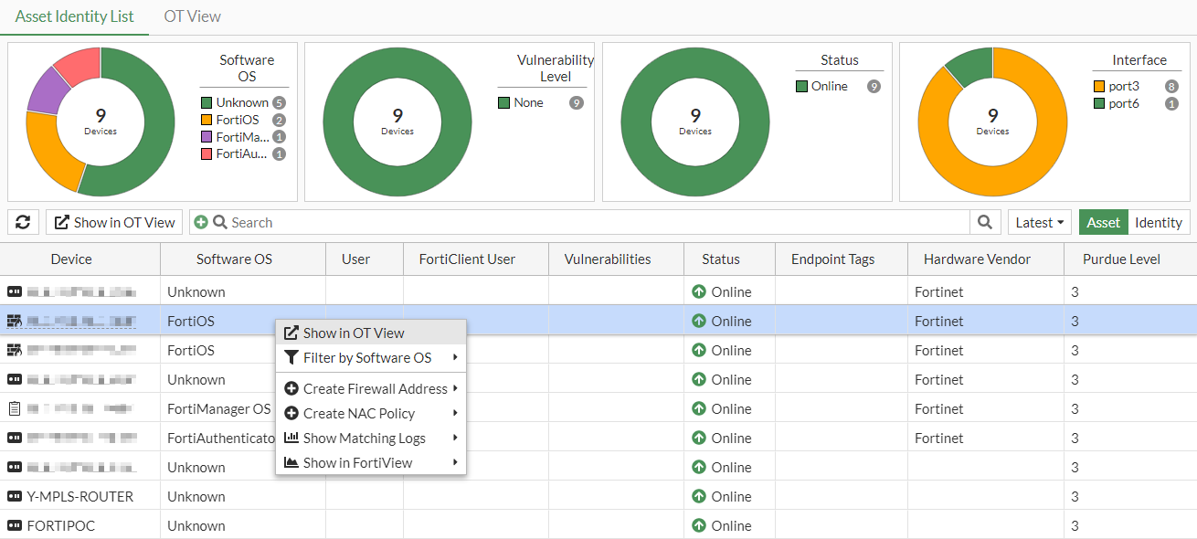

Once enabled, the Security Fabric > Asset Identity Center page displays an Asset Identity List tab and an OT View tab.
- The Asset Identity List tab includes a configurable Purdue Level column and a Show in OT View option for selected devices in the table.

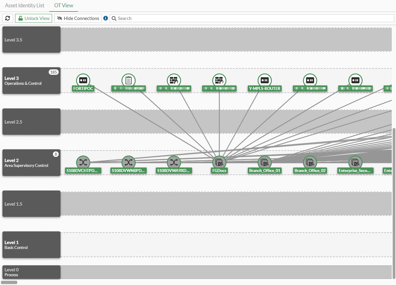

- The OT View tab shows a topology of detected components and connections mapped to Purdue Levels. The default view is locked, but devices can be dragged and dropped to other Purdue Levels if the view is unlocked.
Devices are assigned Purdue Level 3 by default and can be changed (except to level S, 0, or external), including FortiGates, managed FortiSwitches, and FortiAPs.

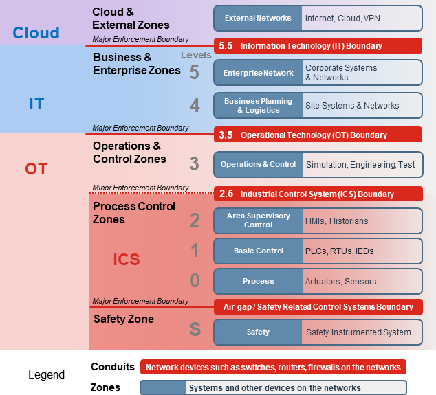

The following diagram lists the Purdue Levels based on OT network topologies:

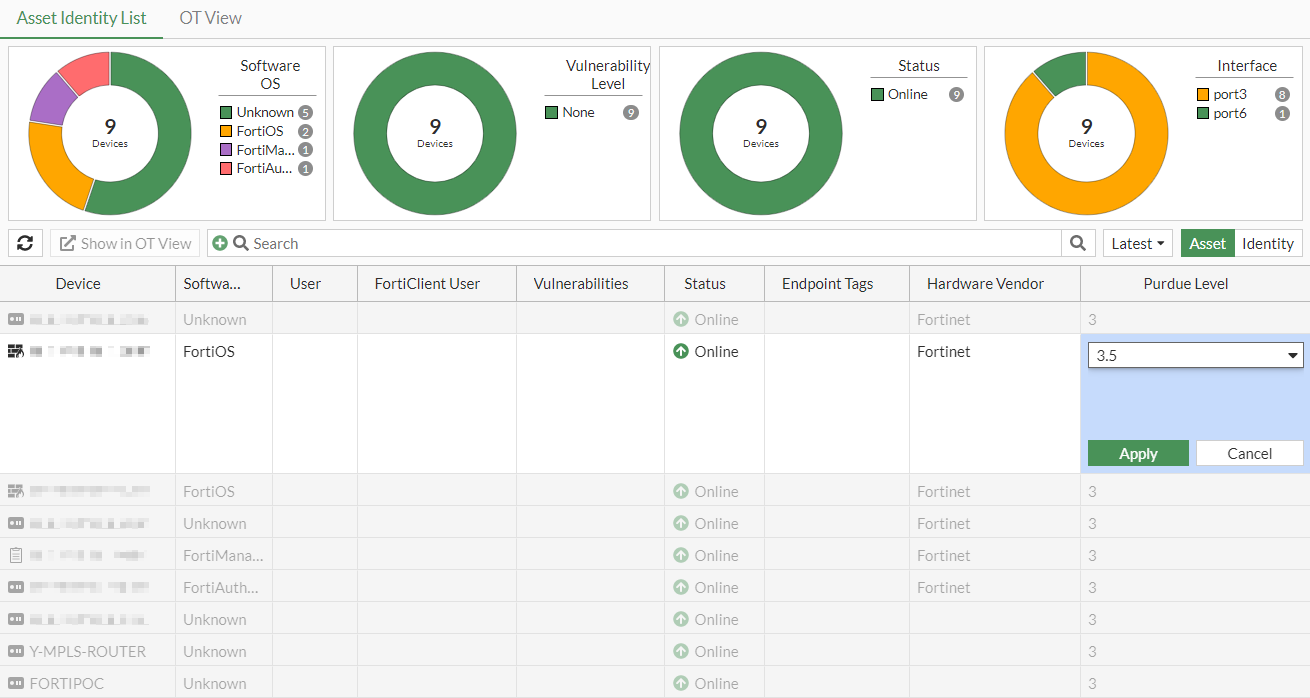

To change the Purdue Level in the Asset Identity List tab:
- Go to Security Fabric > Asset Identity Center and select the Asset Identity List tab.
- Add the Purdue Level column to the table:
- Hover over the table header and click the gear icon (Configure Table).
- Select Purdue Level.
- Click Apply.
- Select a device and hover over the Purdue Level value.
- Click the pencil icon to edit the level.
- Select a value from the dropdown.
- Click Apply.

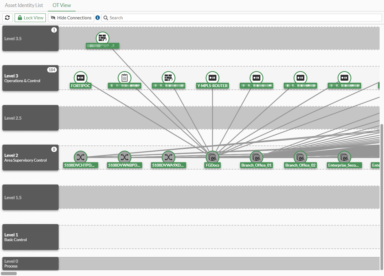

To change the Purdue Level in the OT View tab:
- Go to Security Fabric > Asset Identity Center and select the OT View tab.
- Click Unlock View.
- Select a device.
- Drag the device icon to another level row.
- Optionally, click Lock View to revert to the locked view.

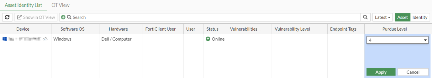

Manually change the device's Purdue Level:
Select the device and hover over the Purdue Level value.
Select 4 and click Apply.
Verify that the Purdue Level as been updated in the user device store list:
# diagnose user-device-store device memory list Record #1: device_info 'ipv4_address' = '192.168.1.64' 'mac' = '**:**:**:**:**:**' 'hardware_vendor' = 'Dell' 'hardware_type' = 'Home & Office' 'hardware_family' = 'Computer' 'vdom' = 'root' 'os_name' = 'Windows' 'os_version' = '10 / 2016' 'last_seen' = '1680115467' 'host_src' = 'mwbs' 'unjoined_forticlient_endpoint' = 'false' 'is_online' = 'true' 'active_start_time' = '1680113976' 'dhcp_lease_status' = 'leased' 'dhcp_lease_expire' = '1680651757' 'dhcp_lease_reserved' = 'false' 'dhcp_server_id' = '2' 'is_fortiguard_src' = 'true' 'purdue_level' = '4' ...
