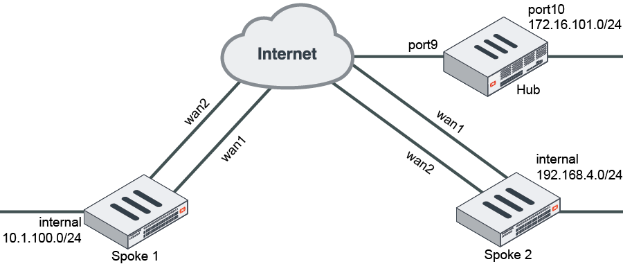

ADVPN with OSPF as the routing protocol
This is a sample configuration of ADVPN with OSPF as the routing protocol. The following options must be enabled for this configuration:
On the hub FortiGate, IPsec phase1-interface
net-device enablemust be run. -
OSPF must be used between the hub and spoke FortiGates.
To configure ADVPN with OSPF as the routing protocol using the CLI:
Configure hub FortiGate's WAN, internal interface, and static route:

Configure the hub FortiGate:
Configure the hub FortiGate IPsec phase1-interface and phase2-interface:
config vpn ipsec phase1-interface edit "advpn-hub" set type dynamic set interface "port9" set peertype any set net-device enable set proposal aes128-sha256 aes256-sha256 3des-sha256 aes128-sha1 aes256-sha1 3des-sha1 set add-route disable set dpd on-idle set auto-discovery-sender enable set psksecret sample set dpd-retryinterval 5 next end config vpn ipsec phase2-interface edit "advpn-hub" set phase1name "advpn-hub" set proposal aes128-sha1 aes256-sha1 3des-sha1 aes128-sha256 aes256-sha256 3des-sha256 next end

Configure the spoke FortiGates:
Configure the spoke FortiGates' WAN, internal interfaces, and static routes:
Configure Spoke1:
config system interface edit "wan1" set alias "primary_WAN" set ip 15.1.1.2 255.255.255.0 next edit "wan2" set alias "secondary_WAN" set ip 12.1.1.2 255.255.255.0 next edit "internal" set ip 10.1.100.1 255.255.255.0 next end config router static edit 1 set gateway 12.1.1.1 set device "wan2" set distance 15 next edit 2 set gateway 15.1.1.1 set device "wan1" next end -
