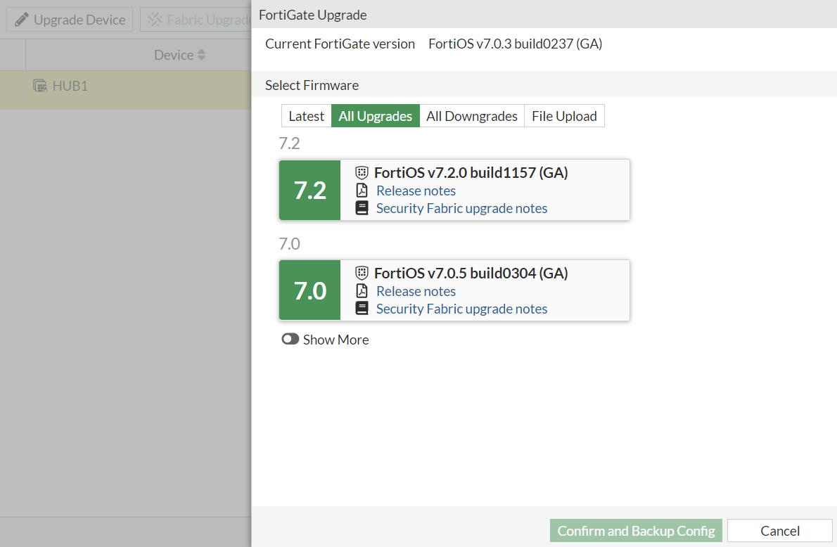

  4. Click All Upgrades. The available firmware versions are displayed.
    In this example, the firmware is available for 7.2 and 7.0.

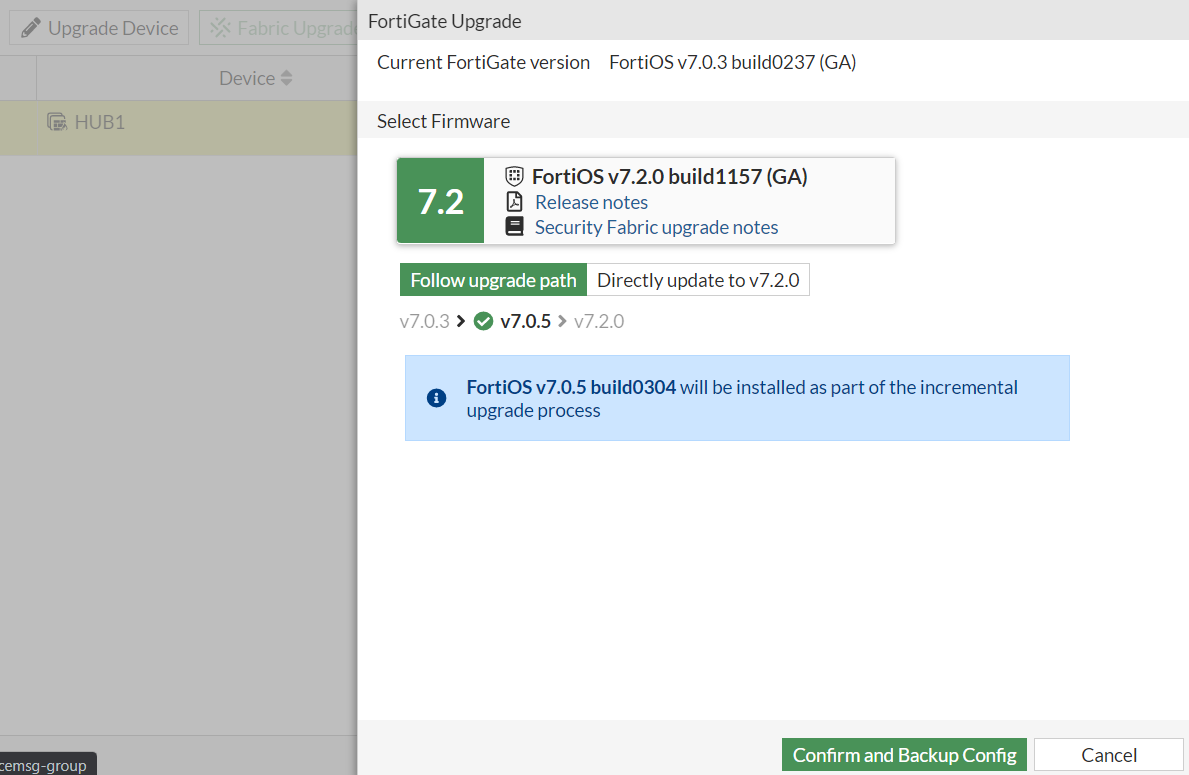

    In this example, the target firmware is 7.2.0 build 1157(GA), and Follow upgrade path is selected. According to the upgrade path, the device can be automatically upgraded to v7.0.5, but not all the way to 7.2.0.

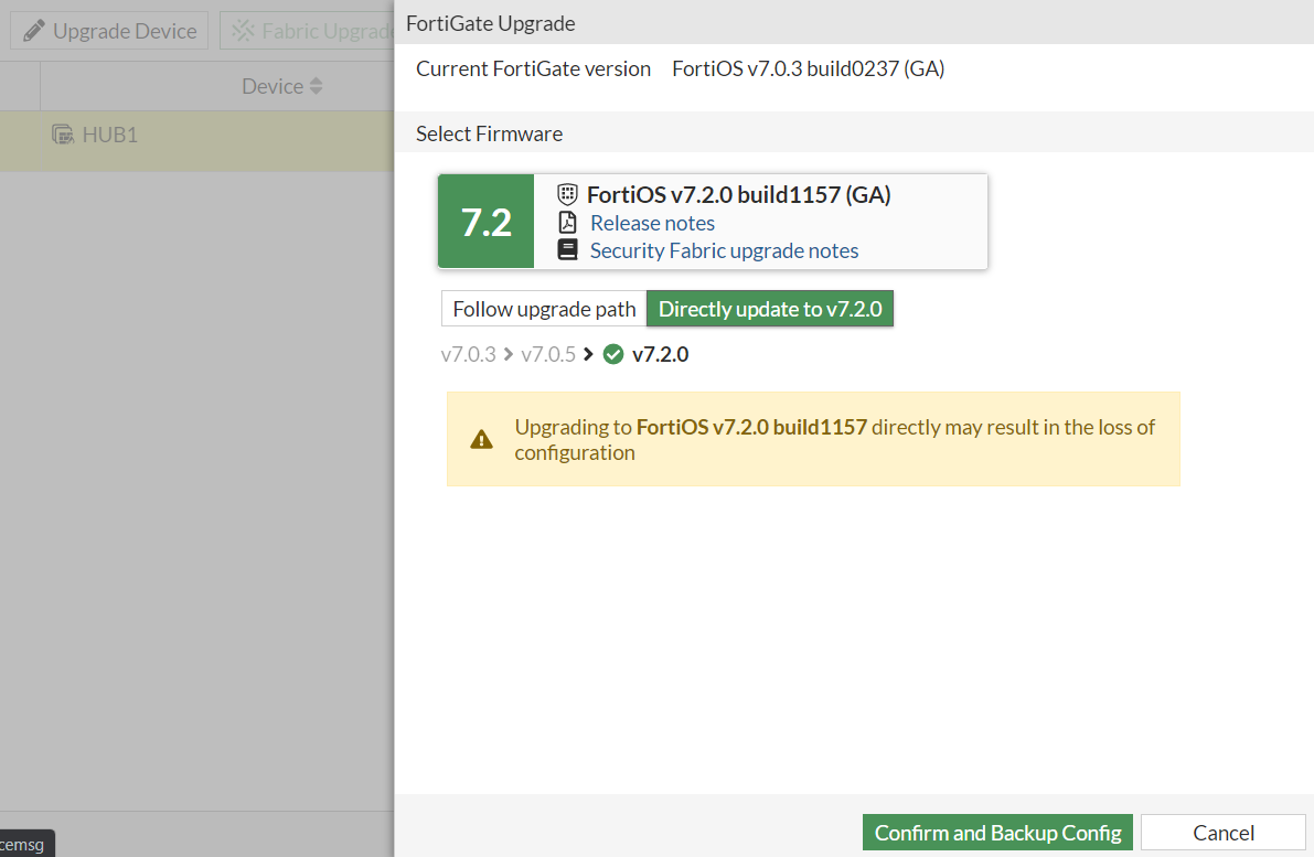

    • In the following example, the Directly update to v7.2.0 option is selected.
  6. Select Follow upgrade path, and click Confirm and Backup Config. A warning message is displayed.
  7. Click Continue to initiate the upgrade.
    The FortiGate unit backs up the current configuration to the management computer, uploads the firmware image file, upgrades to the new firmware version, and restarts. This process takes a few minutes.
