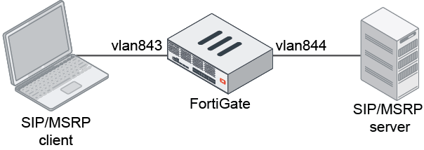

In this first example, MSRP messages larger than 10 bytes will be blocked. The client sends an oversized MSRP message to the server. Message Automation & Protocol Simulation (MAPSTM) is used, and a client-server model was configured to use the software to send MSRP traffic from vlan843 (client) to vlan844 (server) with plain text placed in the message field. The software uses the content of the MsrpInputMessage.txt file located in the default folder, where anything in that file will be sent by MSRP. The following text is used:

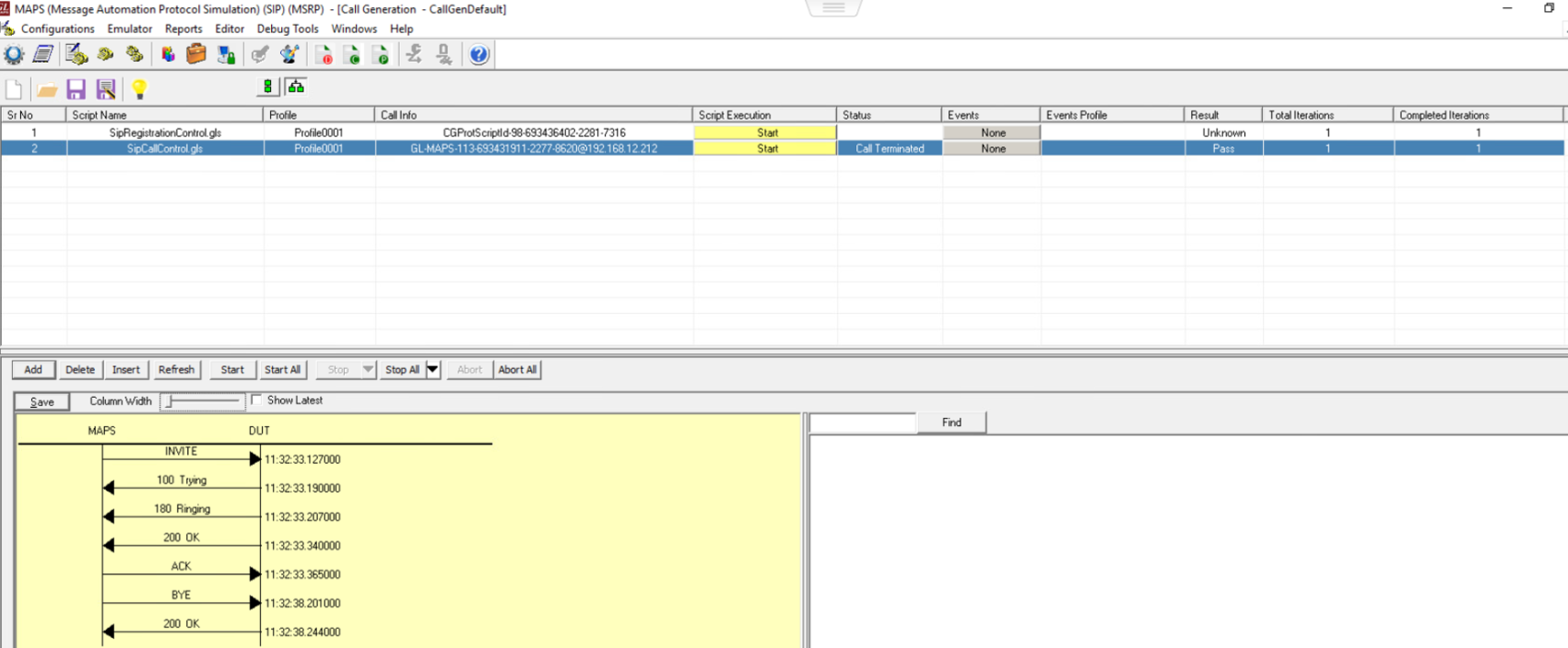

- In MAPS, verify that the call was terminated:
In this second example, malicious files will be blocked. The client sends an EICAR test sample to the server in an MSRP message. Message Automation & Protocol Simulation (MAPSTM) is used, and a client-server model was configured to use the software to send MSRP traffic from vlan843 (client) to vlan844 (server) with a plain text EICAR file containing a virus in the message field. The following text is used:
