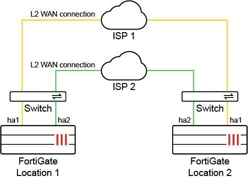

FGCP HA supports cluster units installed in different physical locations to achieve geo-redundancy. This may be desirable in large enterprises that deploy multiple data centers and network infrastructure to prevent interruptions caused by downtime in one location or region. Distributed clusters (or geographically distributed clusters) can have cluster units in different rooms in the same building, different buildings in the same location, or different geographical regions (cities, countries, or continents). When disruption is detected in one location, traffic can be routed to another location and failed over to the HA unit in the same cluster to prevent major downtime.
Just like any FGCP HA cluster, distributed clusters require heartbeat communication between cluster units over a Layer 2 network. In a distributed cluster, this heartbeat communication can take place over a dedicated lease-line, MPLS, or other L2 WAN solutions. Most Data Center Interconnect (DCI) or MPLS-based solutions that support Layer 2 extensions between the remote data centers should also support HA heartbeat communication between the FortiGates in the distributed locations.

Because of the possible distance between the cluster members, it may take longer for heartbeat packets to be transmitted between cluster units. If the time it takes and the possible latency and packet losses cause the configured heartbeat lost threshold to be exceeded, then a split brain scenario can occur (see Split brain scenario).
To avoid this, you can increase the heartbeat interval (the time between the sending of heartbeat packets) so that the cluster expects extra time between heartbeat packets. A general rule is to configure the failover time to be longer than the maximum latency. You could also increase the hb-lost-threshold, which is the number of lost heartbeats to signal a failure, in order to tolerate losing more heartbeat packets if the network connection is less reliable.
To configure the heartbeat interval and lost threshold:
config system ha
set hb-interval <integer>
set hb-lost-threshold <integer>
A longer interval and threshold can lead to slower failover time, and a shorter interval and threshold may lead to false positives. Therefore, these settings should be fine-tuned based on individual network scenarios. Additional options include:
- Using multiple heartbeat interfaces and different link paths for heartbeat packets to optimize HA heartbeat communication.
- Configuring QoS on the links used for HA heartbeat traffic to make sure heartbeat communication has the highest priority.
For information about changing the heartbeat interval and other heartbeat related settings, see Modifying heartbeat timing.
