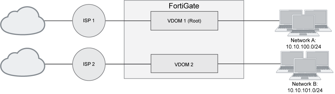

Independent VDOMs
Multiple, completely separate VDOMs are created. Any VDOM can be the management VDOM, as long as it has Internet access to connect to FortiGuard services and other management resources. There are no inter-VDOM links, and each VDOM is independently managed.

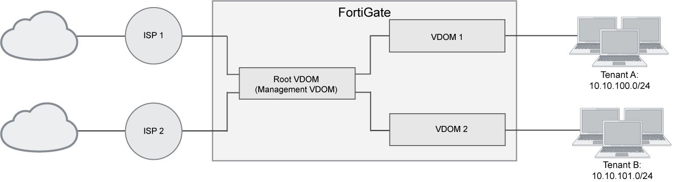

Internet access VDOM
In the Internet access VDOM configuration, Internet access is provided primarily by a single VDOM; for example, the management VDOM (depicted as root VDOM in the preceding diagram). Each tenant connects to the management VDOM via an inter-VDOM link. The management VDOM has complete control over Internet access, including the types of traffic that are allowed in both directions. This can improve security, as there is only one point of ingress and egress.
There is no communication between the other VDOMs.

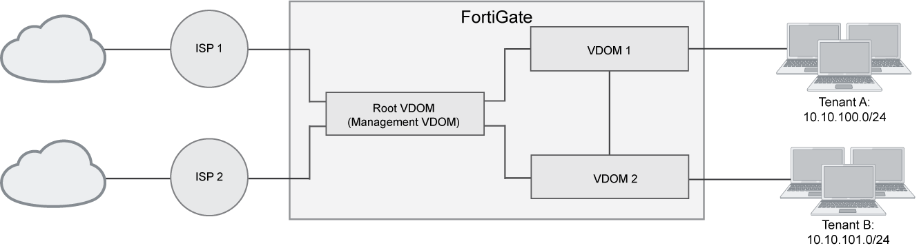

Meshed VDOMs
VDOMs can communicate with inter-VDOM links. In full-mesh configurations, all the VDOMs are interconnected. In partial-mesh configurations, only some of the VDOMs are interconnected.
In this configuration, inter-vdom links between tenants are created by the global administrator, but each tenant controls the firewall policies to allow access to other tenants.
See Inter-VDOM routing and Inter-VDOM routing configuration example: Internet access for configuration details.

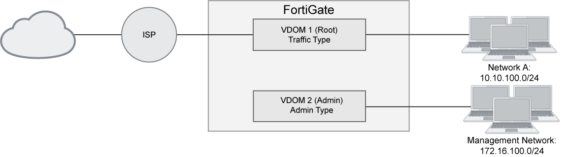

Administrative VDOM on a management network
The administrative VDOM type can be used to limit administrative access to the FortiGate using SSH, HTTPS and so on to administrators working from a management network. Administrators may be limited to management settings or may have global privileges to access other VDOMs. The user or tenant network (depicted as Network A in the diagram) uses a traffic type VDOM, which allows traffic to pass through it like a regular firewall and allows configuration of firewall-related settings. This configuration can improve security if the management network is a closed network and administrative access is not enabled on any interfaces on the traffic VDOM.
