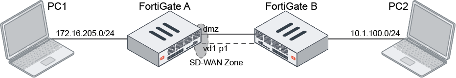

In this example, an IPsec tunnel is configured between two FortiGates that have FEC enabled and supporting configuration to protect traffic that egresses FortiGate A and ingresses FortiGate B. The tunnel is an SD-WAN zone, and an SLA health-check is used to monitor the quality of the VPN overlay. The intention is to apply FEC to UDP traffic that is passing through the VPN overlay, while allowing all other traffic to pass through without FEC. An FEC profile is configured to adaptively increase redundant levels if the link quality exceeds a 10% packet loss threshold, or the bandwidth exceeds 950 Mbps.
The DMZ interface and IPsec tunnel vd1-p1 are SD-WAN members. FEC is enabled on vd1-p1, and health-check works on vd1-p1.
