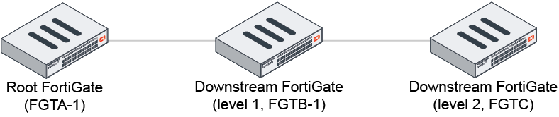

Sample topology
In this Security Fabric, the root FortiGate (FGTA-1) has fabric-object-unification set to default so the Fabric objects can be synchronized to the downstream FortiGate. The level 1 downstream FortiGate (FGTB-1) has configuration-sync set to local, so it will not apply the synchronized objects locally. The level 2 downstream FortiGate (FGTC) has configuration-sync set to default, so it will apply the synchronized objects locally.
In this example, firewall addresses and address groups are used. Other supported Fabric objects have the same behaviors. The following use cases illustrate common synchronization scenarios:

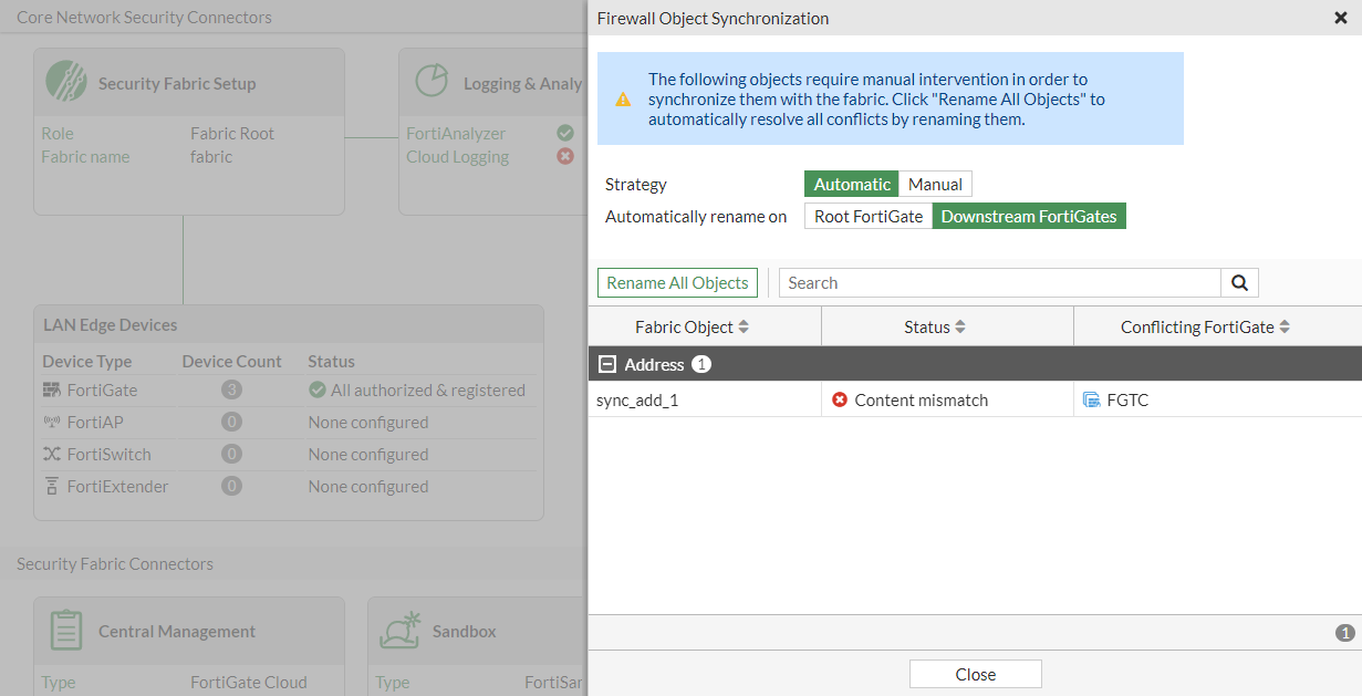

  4. Open the notification center drop dropdown. There is a message that 1 Firewall object is conflict with other FortiGates in the fabric.
  5. Resolve the conflict:
    1. Click the message in the notification center drop dropdown. The Firewall Object Synchronization pane opens.

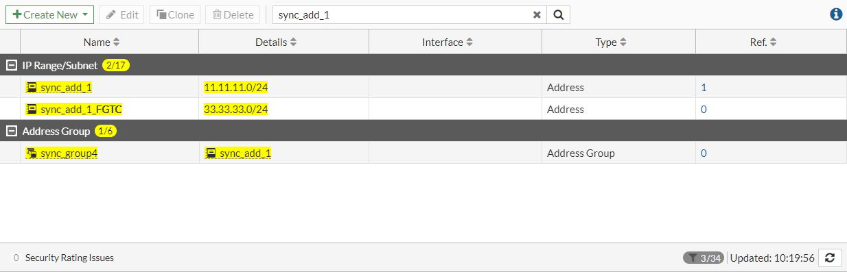

    2. Click Rename All Objects. The conflicted object will be renamed on the downstream FortiGate.
    3. The conflict is resolved. Click Close to exit the Firewall Object Synchronization pane.

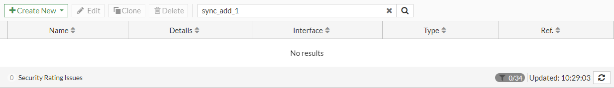

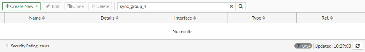

  6. Verify the results on the downstream FortiGates:
    1. On FGTB-1, go to Policy & Objects > Addresses.
    2. Search for sync_add_1 and sync_group4. No results are found. The synchronized objects are not applied locally on this FortiGate because configuration-sync is set to local.
    3. On FGTC, go to Policy & Objects > Addresses.
    4. Search for sync_add_1. The original firewall address sync_add_1 was renamed to sync_add_1_FGTC by resolving the conflict on FGTA-1. The address sync_add_1 and address group sync_group4 are synchronized from FGTA-1.

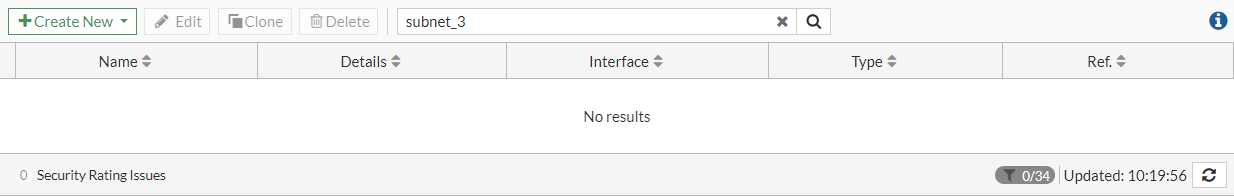

  3. On FGTB-1, go to Policy & Objects > Addresses and search for subnet_3. No results are found because Fabric synchronization is disabled on the root FortiGate (FGTA-1).
  4. On FGTC, go to Policy & Objects > Addresses and search for subnet_3. No results are found because Fabric synchronization is disabled on the root FortiGate (FGTA-1).

    FGTB-1 # show firewall address add_subnet_1
    entry is not found in table
    FGTB-1 # show firewall addrgrp group_subnet_1
    FGTC # show firewall address add_subnet_1
    config firewall address
        edit "add_subnet_1"
            set uuid 378a8094-34cb-51eb-ce40-097f298fcfdc
            set fabric-object enable
            set subnet 22.22.22.0 255.255.255.0
    FGTC # show firewall addrgrp group_subnet_1
    config firewall addrgrp
        edit "group_subnet_1"
            set uuid 4d7a8a52-34cb-51eb-fce7-d93f76915319
            set member "add_subnet_1"
            set color 19
    The objects are synchronized on this FortiGate because configuration-sync is set to default.
