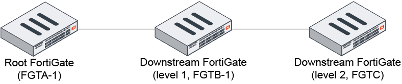

Sample topology
In this Security Fabric, the root FortiGate (FGTA-1) has fabric-object-unification set to default so the Fabric objects can be synchronized to the downstream FortiGate. The level 1 downstream FortiGate (FGTB-1) has configuration-sync set to local, so it will not apply the synchronized objects locally. The level 2 downstream FortiGate (FGTC) has configuration-sync set to default, so it will apply the synchronized objects locally.
In this example, firewall addresses and address groups are used. Other supported Fabric objects have the same behaviors. The following use cases illustrate common synchronization scenarios:

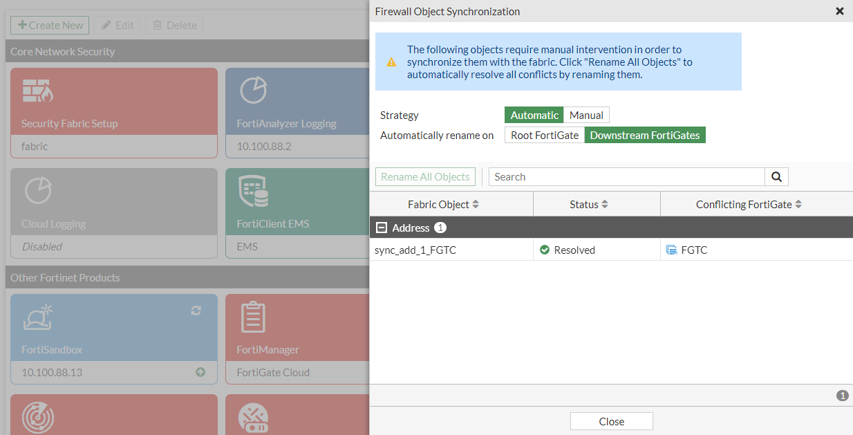

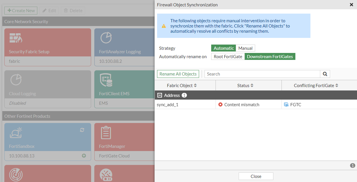

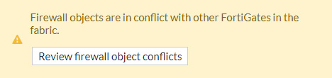

  4. Go to Security Fabric > Fabric Connectors. In the topology tree, there is a message that Firewall objects are in conflict with other FortiGates in the fabric.
  5. Resolve the conflict:
    1. Click Review firewall object conflicts. The Firewall Object Synchronization pane opens.
    2. Click Rename All Objects. The conflicted object will be renamed on the downstream FortiGate.
    3. The conflict is resolved. Click Close to exit the Firewall Object Synchronization pane.
    4. The topology tree no longer indicates there is a conflict.

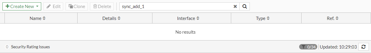

  6. Verify the results on the downstream FortiGates:
    1. On FGTB-1, go to Policy & Objects > Addresses.
    2. Search for sync_add_1 and sync_group4. No results are found. The synchronized objects are not applied locally on this FortiGate because configuration-sync is set to local.
    3. On FGTC, go to Policy & Objects > Addresses.
    4. Search for sync_add_1. The original firewall address sync_add_1 was renamed to sync_add_1_FGTC by resolving the conflict on FGTA-1. The address sync_add_1 and address group sync_group4 are synchronized from FGTA-1.
