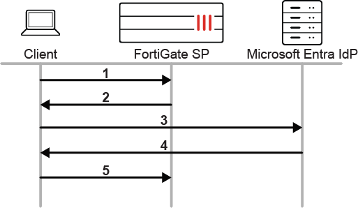

To illustrate the communication between the user or browser, SP, and IdP:
  1. The user initiates an SSL VPN connection to the FortiGate.
  2. The FortiGate SP redirects the user to the SAML IdP.
  3. The user connects to the Microsoft log in page for the SAML authentication request.
  4. The SAML IdP authenticates the user and sends the SAML assertion containing the user and group.
  5. The browser forwards the SAML assertion to the FortiGate SP. If the user and group are allowed by the FortiGate, the user is allowed to access the application, in this case, connecting to SSL VPN.
