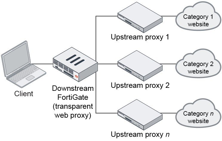

Selectively forward web requests to a transparent web proxy
Web traffic over HTTP/HTTPS can be forwarded selectively by the FortiGate's transparent web proxy to an upstream web proxy to avoid overwhelming the proxy server. Traffic can be selected by specifying the proxy address, which can be based on a FortiGuard URL category.
The FortiGuard web filter service must be enabled on the downstream FortiGate.
Topology
Forwarding behavior
The forward server will be ignored if the proxy policy matching for a particular session needs the FortiGate to see authentication information inside the HTTP (plain text) message. For example, assume that user authentication is required and a forward server is configured in the transparent web proxy, and the authentication method is an active method (such as basic). When the user or client sends the HTTP request over SSL with authentication information to the FortiGate, the request cannot be forwarded to the upstream proxy. Instead, it will be forwarded directly to the original web server (assuming deep inspection and http-policy-redirect are enabled in the firewall policy).

Sample configuration
On the downstream FortiGate proxy, there are two category proxy addresses used in two separate transparent web proxy policies as the destination address:
  • In the policy with upstream_proxy_1 as the forward server, the proxy address category_infotech is used to match URLs in the information technology category.
  • In the policy with upstream_proxy_2 as the forward server, the proxy address category_social is used to match URLs in the social media category.
Topology
Forwarding behavior
