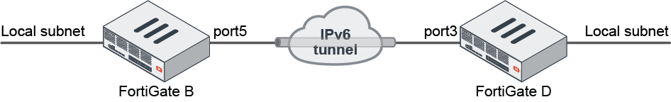

The MTU of an IPv6 tunnel interface is calculated from the MTU of its parent interface minus headers.
Example
In this topology, FortiGate B and FortiGate D are connected over an IPv6 network. An IPv6 tunnel is formed, and IPv4 can be used over the IPv6 tunnel. The tunnel interface MTU is based on the physical interface MTU minus the IP and TCP headers (40 bytes). On FortiGate B's physical interface port5, the MTU is set to 1320. The IPv6 tunnel is based on port5, and its MTU value of 1280 is automatically calculated from the MTU value of its physical interface minus the header. The same is true for port3 on FortiGate D.
Example
