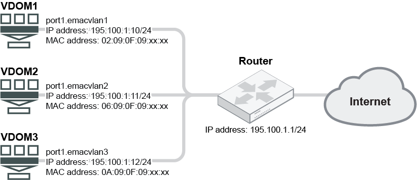

Example 1: Enhanced MAC VLAN configuration for multiple VDOMs that use the same interface or VLAN
In this example, a FortiGate is connected, through port 1 to a router that’s connected to the Internet. Three VDOMs share the same interface (port 1) which connects to the same router that’s connected to the Internet. Three enhanced MAC VLAN interfaces are configured on port 1 for the three VDOMs. The enhanced MAC VLAN interfaces are in the same IP subnet segment and each have unique MAC addresses.
The underlying interface (port 1) can be a physical interface, an aggregate interface, or a VLAN interface on a physical or aggregate interface.
