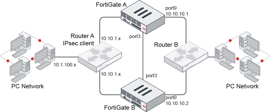

Example
In this example, FortiGate A and FortiGate B are FGSP peers with port3 as the session synchronization link. The FortiGates act as IPsec dial-up servers and PCs on the 10.1.100.0 subnet are the IPsec dial-up clients. Router A acts as the external load balancer for IKE sessions between the FortiGates. Dynamic routing OSPF is configured for the FortiGates and routers.
When PC2 and other clients form IPsec dial-up tunnels to the FGSP peers, these tunnels terminate on either FortiGate A or FortiGate B, not both. For each tunnel, one FortiGate is the primary and the other is the secondary.
When the session synchronization link goes down, the FGSP split-brain scenario occurs. Without using the IKE monitor mechanism, the IKE and ESP information becomes out of sync between the two FortiGates. The secondary FortiGate for a tunnel does not receive any information about updated tunnel status. If there is a failover and tunnel traffic begins to flow to the secondary FortiGate, the tunnel will be invalidated because its state tables for that session are out of sync.
By using the IKE monitor when a split-brain scenario occurs, each unit starts periodically monitoring traffic flows and managing the sequence number jump ahead on standby units. Using a combination of timers with ESP sequence number jump ahead lets the units maintain integrity of the shared SA runtime state table, including ESP anti-replay sequence numbers.
Once the session synchronization link is up, the FGSP peers synchronize the state tables and resume regular operations.
