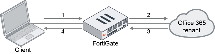

- When a user attempts to access login.microsoftonline.com, login.microsoft.com, or login.windows.net, the traffic will match a proxy inspection mode firewall policy with the assigned web proxy profile.
- The web proxy profile adds new headers to the customer tenant, indicating the allowed domain and restricted access for personal accounts. Next, the FortiGate starts a new connection with the Microsoft Office 365 domain controller including the new headers.
- The Microsoft Office 365 domain controller assesses this data and will allow or deny this access, then sends a reply to the FortiGate.
- The FortiGate sends a reply to the client.
The FortiGate will only indicate the correct domains to be allowed or denied through the headers to Microsoft. The custom sign-in portal in the browser is generated by Microsoft.

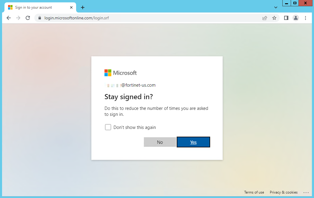

Testing the access
To test the access to corporate domains and personal accounts:
- Get a client to log in with their corporate email using the login.microsoftonline.com domain.
- The client is able to enter their credentials and log in successfully.
- Get a client to log in to their personal Outlook account.
- After the client enters their credentials, a message appears that they cannot access this resource because it is restricted by the cross-tenant access policy.
