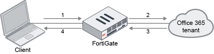

In this example, a web proxy profile is created to control permissions for Microsoft Office 365 to allow corporate domains and deny personal accounts, such as Hotmail and Outlook that are accessed through login.live.com.
  1. When a user attempts to access login.microsoftonline.com, login.microsoft.com, or login.windows.net, the traffic will match a proxy inspection mode firewall policy with the assigned web proxy profile.
  2. The web proxy profile adds new headers to the customer tenant, indicating the allowed domain and restricted access for personal accounts. Next, the FortiGate starts a new connection with the Microsoft Office 365 domain controller including the new headers.
  3. The Microsoft Office 365 domain controller assesses this data and will allow or deny this access, then sends a reply to the FortiGate.
  4. The FortiGate sends a reply to the client.
The FortiGate will only indicate the correct domains to be allowed or denied through the headers to Microsoft. The custom sign-in portal in the browser is generated by Microsoft.

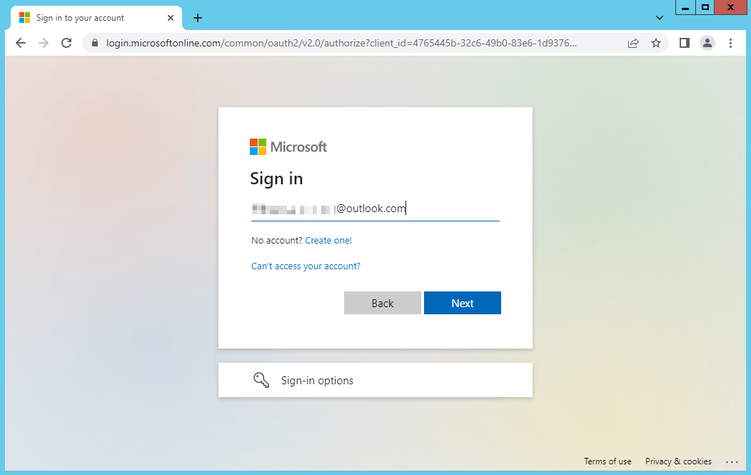

Testing the access
To test the access to corporate domains and personal accounts:

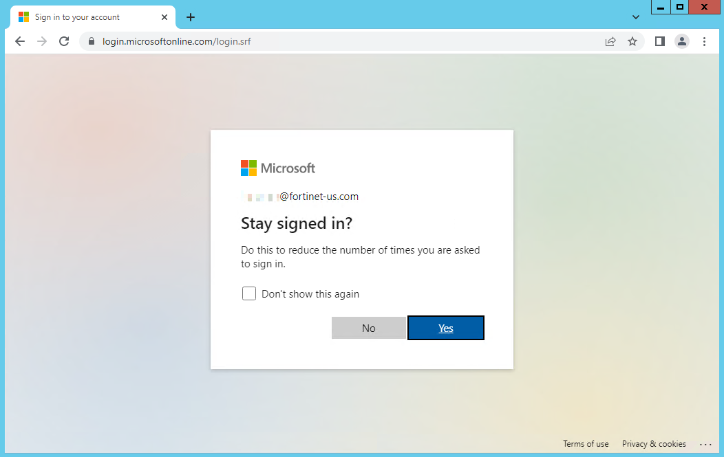

  1. Get a client to log in with their corporate email using the login.microsoftonline.com domain.
  2. The client is able to enter their credentials and log in successfully.

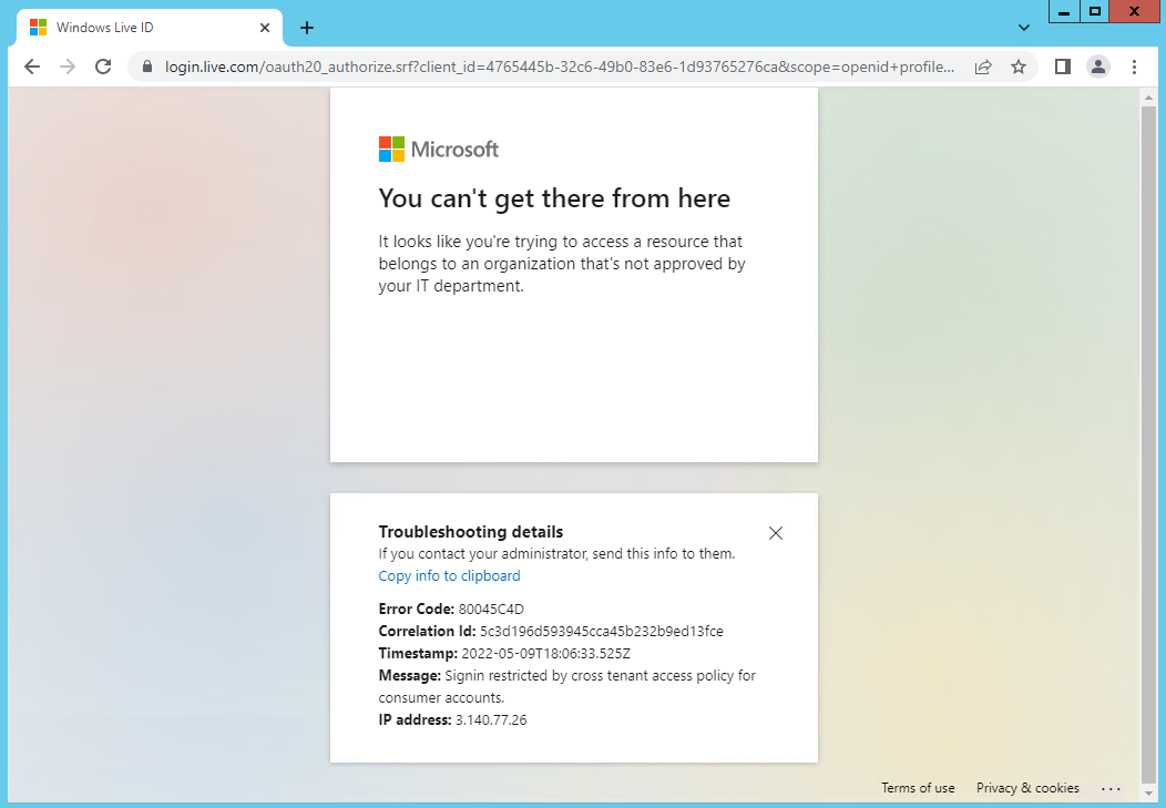

  3. Get a client to log in to their personal Outlook account.
  4. After the client enters their credentials, a message appears that they cannot access this resource because it is restricted by the cross-tenant access policy.

  • A web filter profile in proxy mode with static URL filters for the SNI URLs
  • A web proxy profile that adds new headers to the customer tenant
  • A firewall policy using proxy mode inspection that applies the configured SSL SSL inspection, web filter, and web proxy profiles
The Restrict-Access-To-Tenants and Restrict-Access-Context headers are inserted for incoming requests to: login.microsoftonline.com, login.microsoft.com, and login.windows.net, which are part of the Microsoft Office 365 address group.
To restrict access to personal accounts using the login.live.com domain, the sec-Restrict-Tenant-Access-Policy header is inserted and uses restrict-msa as the header content.
